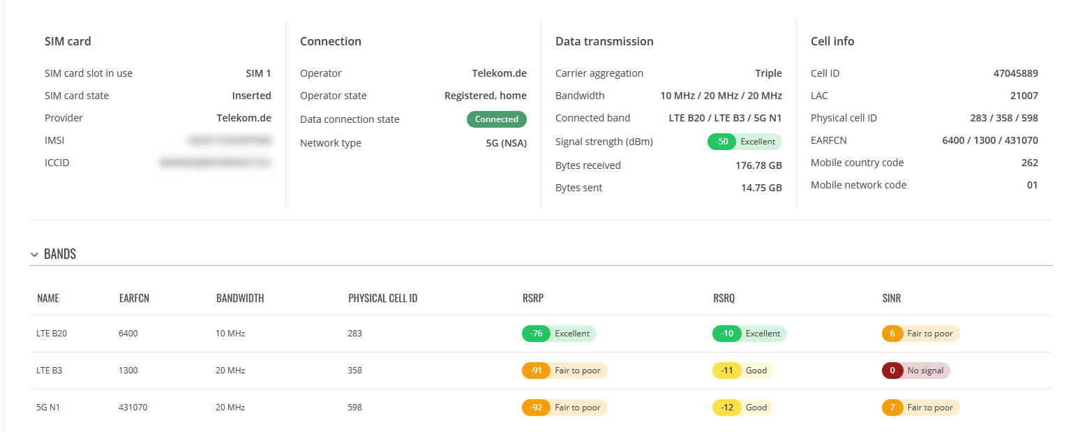

now we make progress. I have now 5G ⦠here the screenshot
the speed is better ⦠but not really good
~ 28 Mbit download
~ 58 Mbit upload

In this case, it seems like the signal strength may be the main issue remaining. Please try placing the device near a window oriented towards the closest cell tower from your operator. Most cell towers are mapped on this page: Cellular Tower and Signal Map (Iād suggest checking 4G towers, as they are often in the same location as the 5G ones, and are mapped much better).
Lastly, investing into a directional external antenna may also be a good option. More information and recommendations can be found here: Third-party Antennas - Teltonika Networks Wiki

I have two external antennas ⦠and both are direct adjusted to the sender tower ⦠which I can see from my house
In the beginning I had over 120 MBIT ⦠and now much better than the last weeks ⦠with ~ 30 MBIT but not really perfect ⦠but of course this can be related as well to TELEKOM ⦠this is for me difficult to catch
Let us know if the Telekom team can find anything. Thank you.
ok TK answered ⦠all is ok with the sender ⦠maybe the bandwith but they will not change it ⦠which is obviously a business decision ⦠I do not know
In 4 month I will get fibre ⦠and then I hope I have never to use LTE ā¦
Thanks for the moment and for the support
