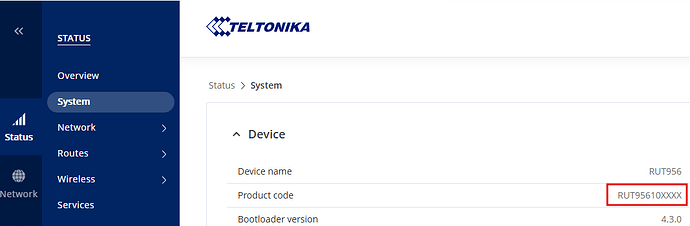

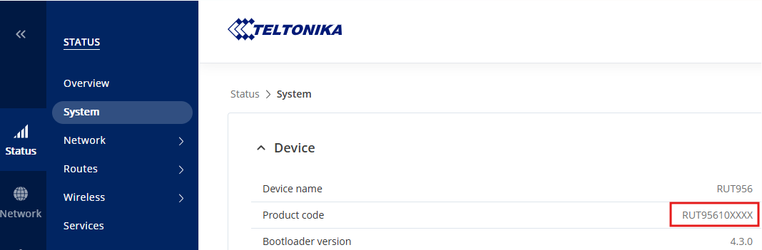

Does you device code start with RUTX5032 **** ?
As @hrtx has mentioned, please check the product code of your device, only codes starting with RUTX5032 has the eSIM functionality.
You can find the product code of the device on the box itself
Or in the WebUI go to Status - > System and there you can see the Product code
