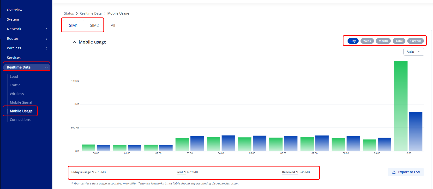

Could you please check on your device how things are looking under
Status → Realtime Data → Mobile usage?
Say you were to refresh the page every few minutes or so, do the numbers also decrease here? Unfortunately for me, but I don’t seem to be having the same issue, could you perhaps tell me how you were initially monitoring this without the script you wrote? Are you certain that you are not taking a certain time frame that takes, let’s say, the last 5 minutes or so, which in essence would make sense that the data usage decreases since you might’ve not used as much data in the last 5 minutes as in the next 5, or vice versa (sounds a bit complicated).
