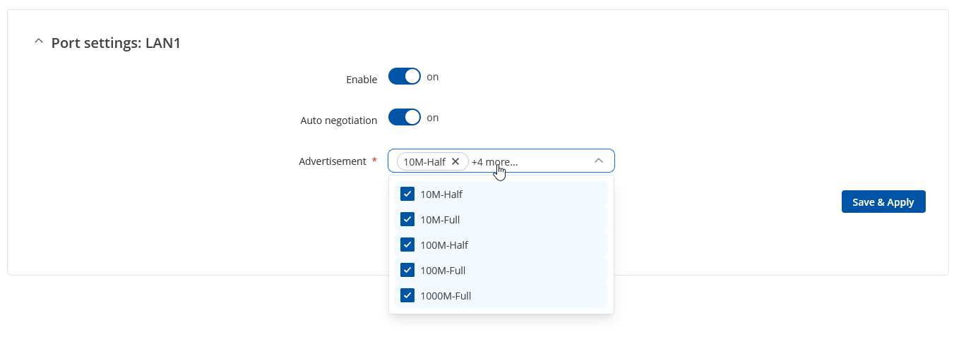

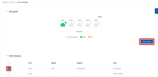

Regarding port settings, you can check them in Network → Ports → Ports Settings. There you can check each port’s setting individually if the correct settings are set.
