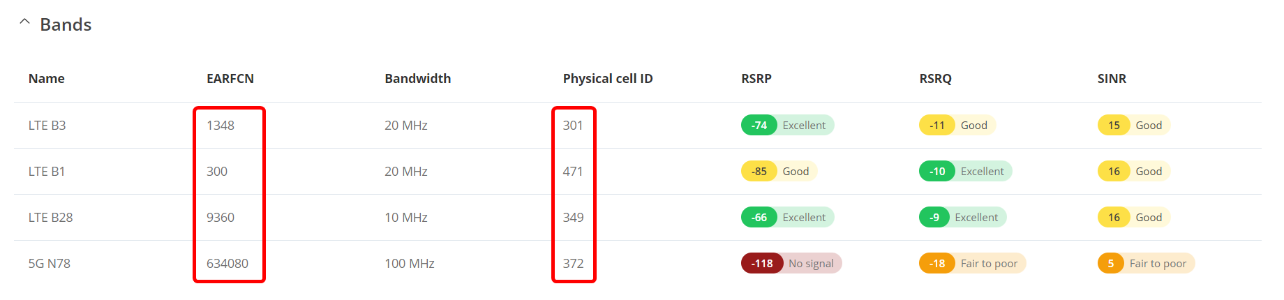

do you perhaps know the interpretation of these figures for the AT command AT+QNWCFG=“lte_mimo_info” ?
So far I understand that the first ones are PCI and EARFCN

Quectel does not provide any information on the output of this command, but judging by the output for LTE and 5G:
root@RUTX50:~# gsmctl -A 'at+QNWCFG="nr5g_mimo_info"'
+QNWCFG: "nr5g_mimo_info",372,634080,2,1
+QNWCFG: "nr5g_mimo_info",535,634080,2,1
+QNWCFG: "nr5g_mimo_info",667,634080,2,1
root@RUTX50:~# gsmctl -A 'at+QNWCFG="lte_mimo_info"'
+QNWCFG: "lte_mimo_info",301,1348,4,1
+QNWCFG: "lte_mimo_info",471,300,0,0
+QNWCFG: "lte_mimo_info",349,9360,0,0
The first two numbers do in fact represent PCI and (E)ARFCN, the third letter could be the MIMO status (in the case of EARFCN 1348 - 4x4 MIMO), and the fourth number could represent the availability of MIMO for that particular carrier.
