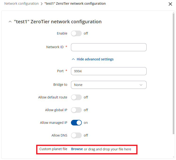

Hello @sensorsiot,
Hope you’re doing well!
I wanted to let you know that RutOS firmware version 7.13 is now available. You can download it here: RUTX50 Firmware Downloads.
With this firmware, you should be able to upload a custom planet file to your ZeroTier configuration:
Please feel free to reach out if you need any further assistance with this!
