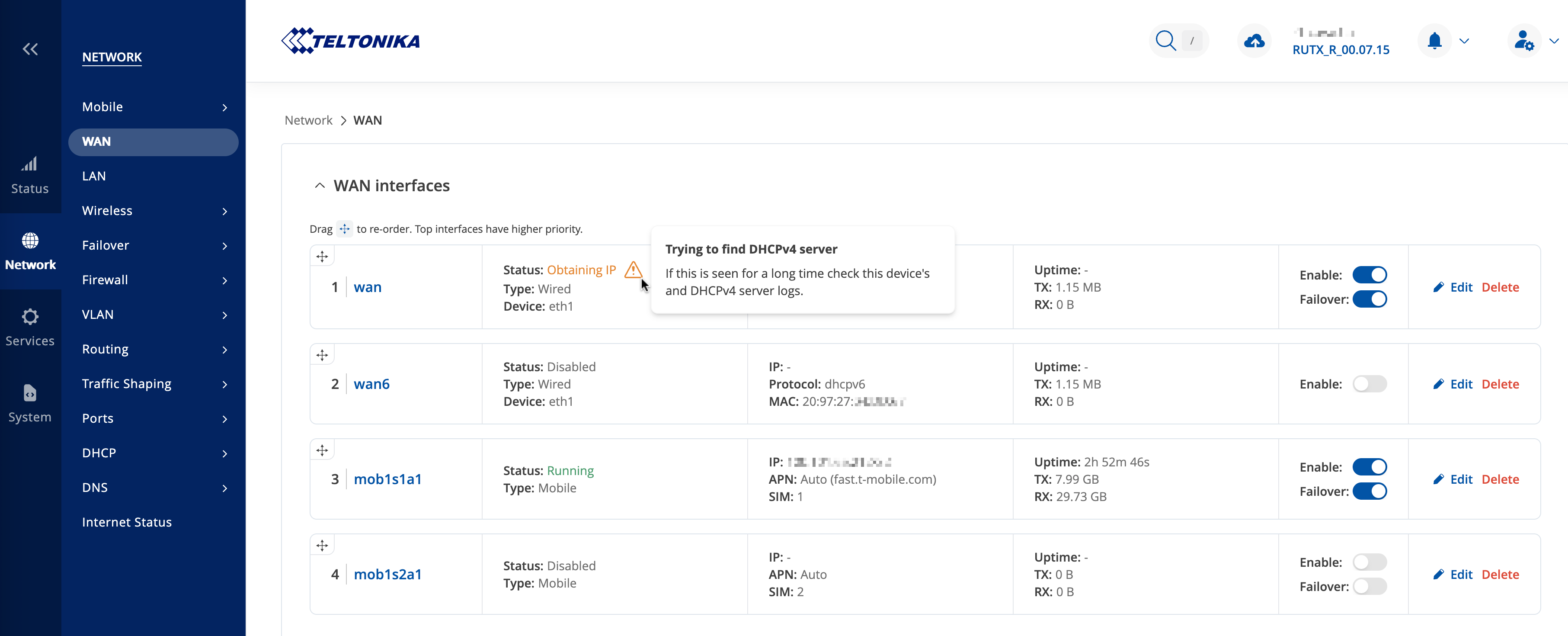

Something new today… never seen this before. Upgraded another RUTX11 last night, after rebooting, the primary WAN (eth1) was offline. No DHCP was being received from the ISP modem (Spectrum). I tried rebooting the RUT but that did not help. I also tried forcing the Ethernet port to 1000M in case it was an autoneg thing (it wasn’t).
I ran tcpdump
on the eth1 interface and saw DHCP requests going out, but no responses back. I had to call the ISP and have them power cycle the modem on their end, after about 10 minutes the DHCP reply came in and everything was working again.
