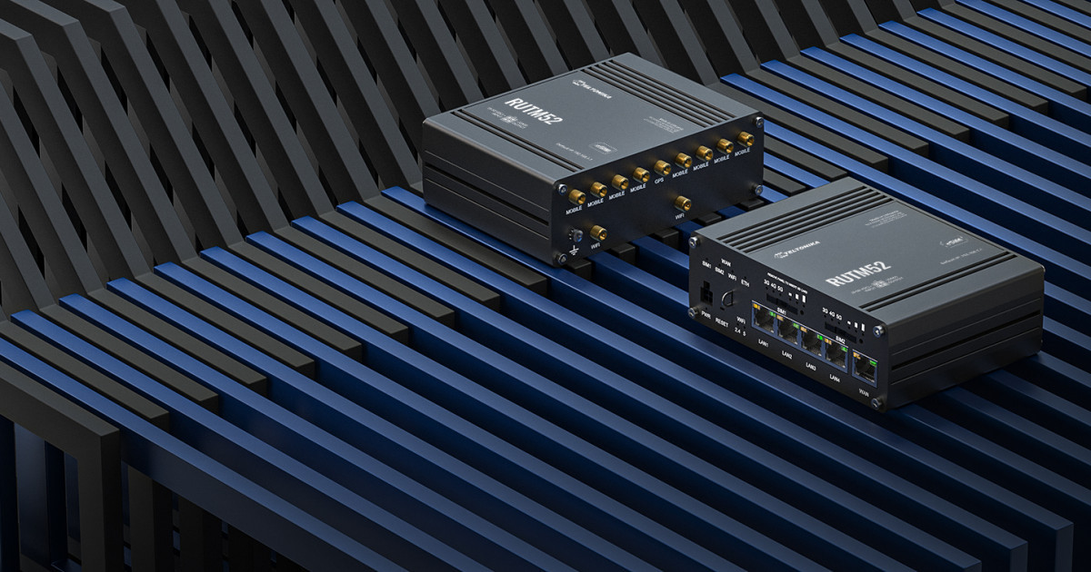

Are you look for a device with two LTE Modem?
Take a look at RUTM52… sample
