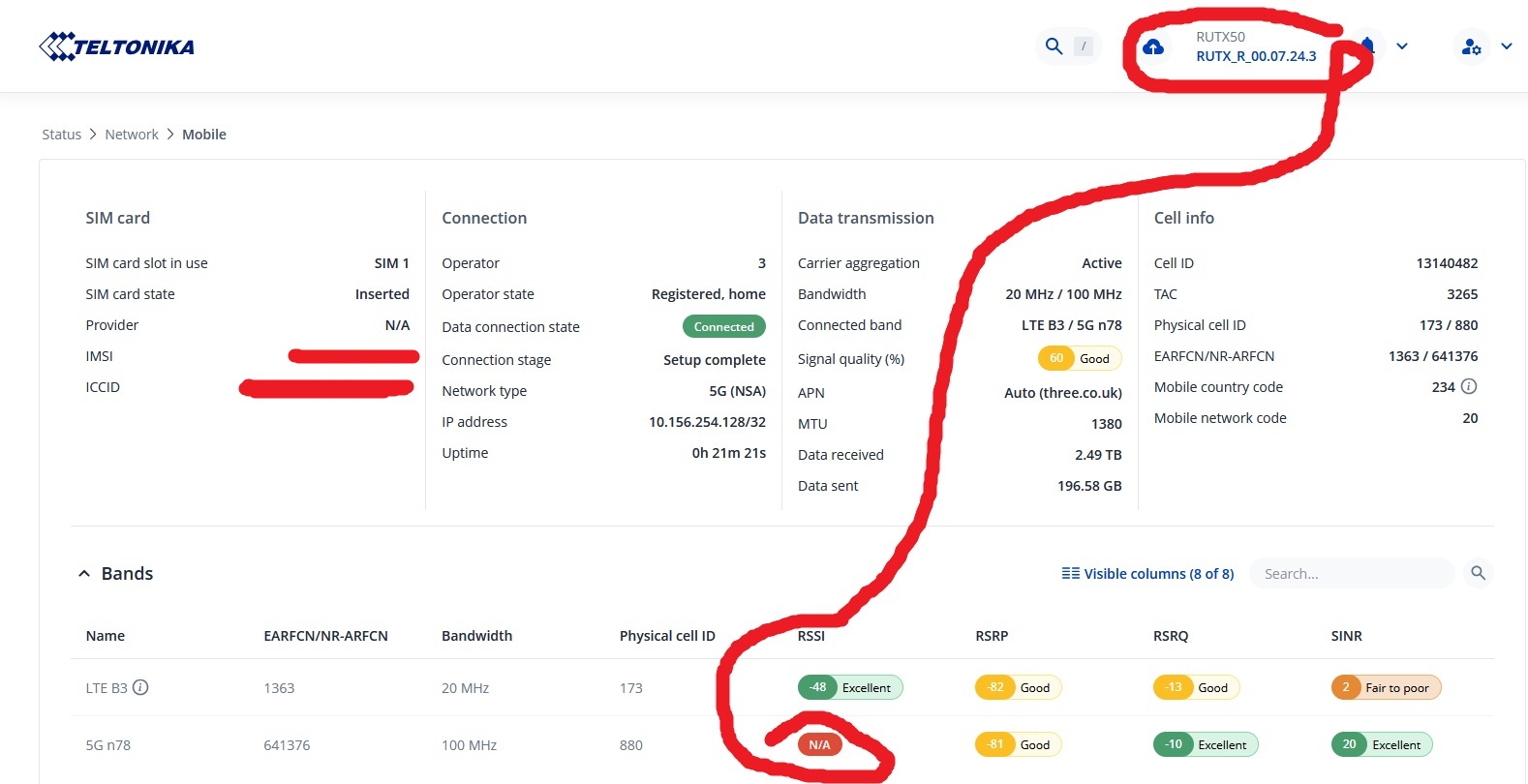

Just upgraded from 07.24.1 to 07.24.3 and i have one outstanding issue (See Image) and i had a carry on getting a networked USB drive working on our Win11 desktops and laptops. Everyones smartphones didn’t have an issue, just MS windows devices.
After a number of RUT and MS windows device reboots and resetting the share password access to the USB drive was eventually restored.
If I understand correctly, the issue you are experiencing is that the RSSI value for the 5G band is displayed as N/A.
This issue was fixed in firmware version 7.25.1 for RUTX and RUTM devices. Could you please update the firmware to the latest version and let me know if this resolves the issue?
