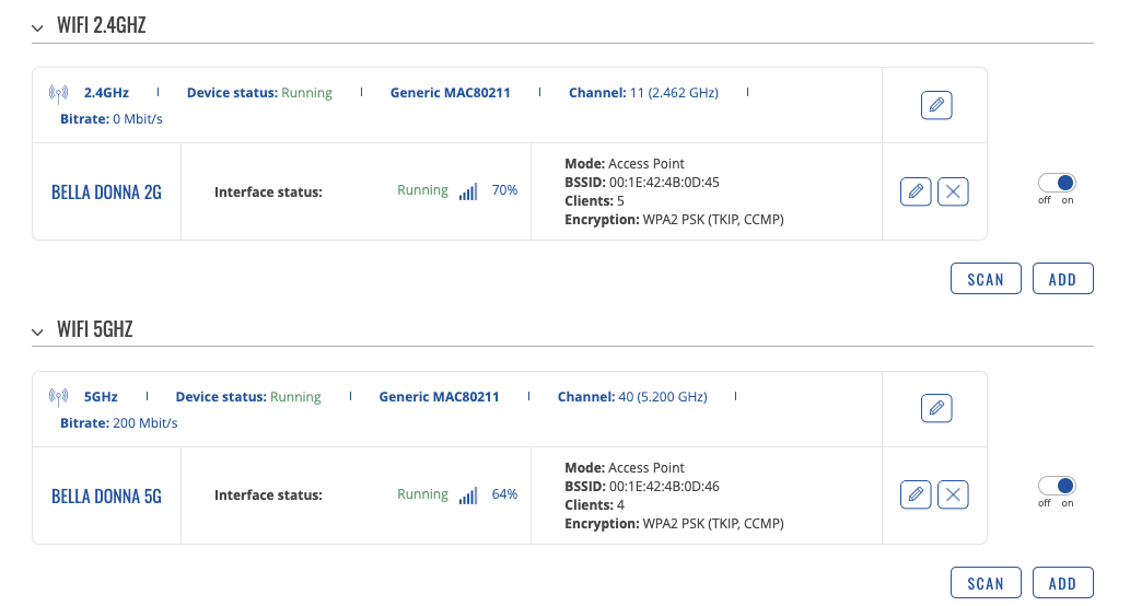

Perhaps you could post screenshots of your WiFi interface, it’s advanced and security settings, as well as status with the sensitive information blurred out? This might help identify the issue on hand. Some things that can be tried:

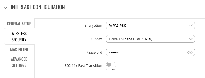

  • Use WPA2-PSK encryption. While it is theoretically less secure, it is supported much better across different devices;
  • Make sure you are on the latest firmware;
  • Try using different cyphers;

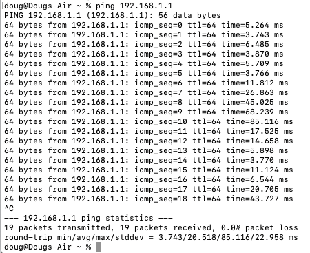

I will also ask you to open Terminal on your Mac and run the command ping 192.168.1.1 (or use a different IP address if it was changed on the RUTX14). Run it for around 20 seconds and post the output in the next message.

I have been using WPA2-PSK all along.

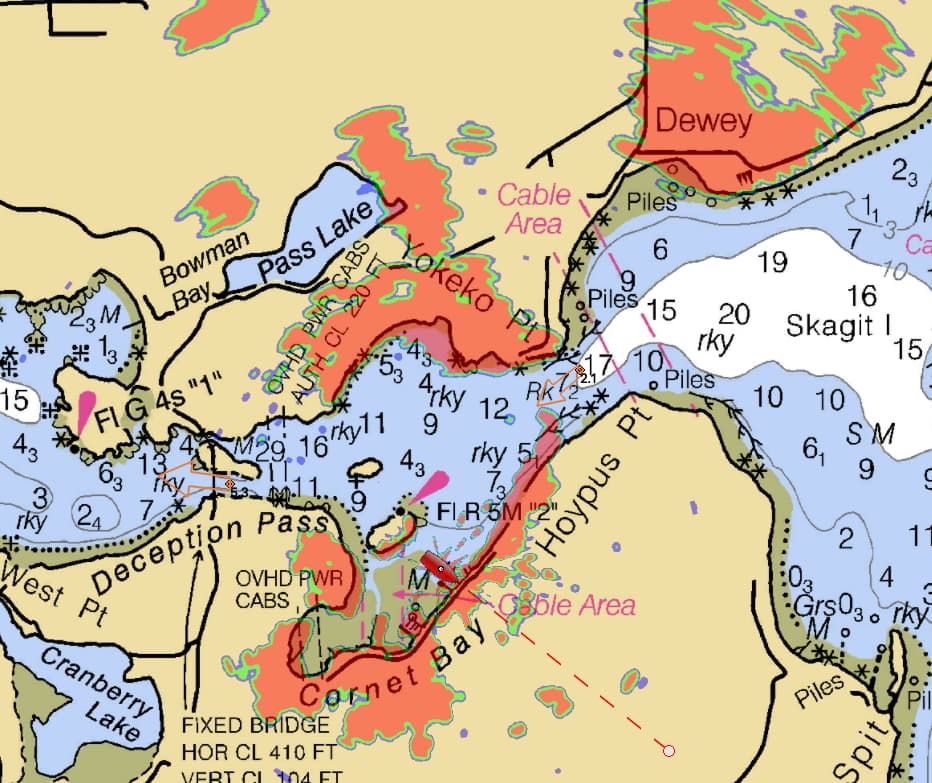

This is what the radar looks like when data is lost.
Here’s a screenshot of the Terminal ping:

Here’s a screenshot of a Terminal ping:
