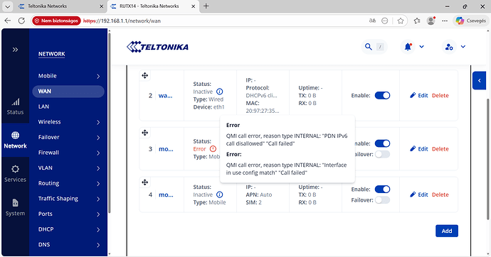

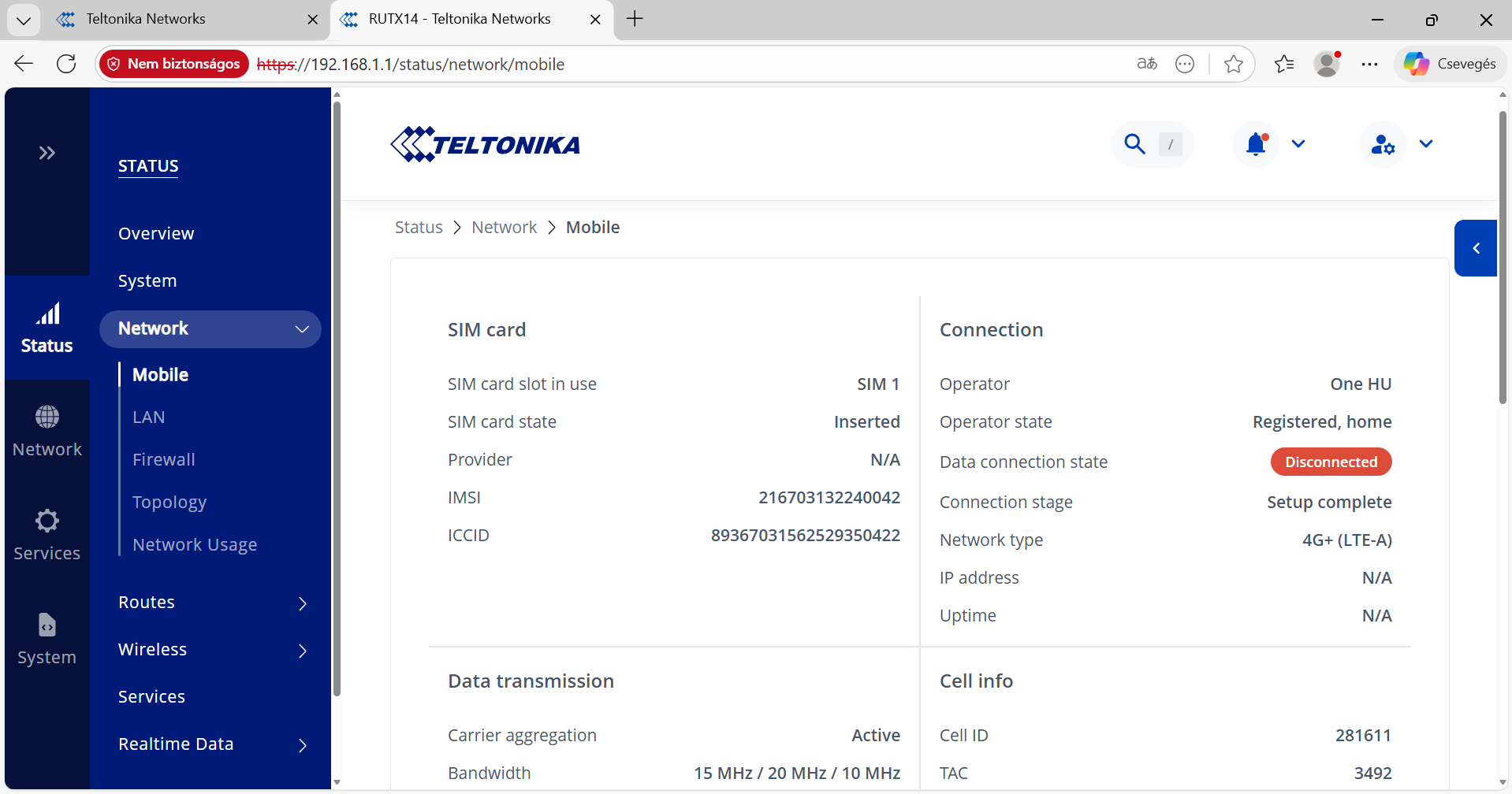

I’m facing the same issue regarding the mobile as ticket number 13723. I tried all of these and neither worked so far:
Check with your provider whether the router’s IMEI is blocked.
Verify SIM card compatibility:
Check if the SIM card supports both IPv4 and IPv6 PDP types.
If it only supports IPv4, set the PDP type to IPv4 only.
Perform a network scan:
Go to Network → Mobile → Network Operators and start a scan.
After the scan, you should see which operators the modem can attempt to connect to.
Try manual band selection:
Go to Network → Mobile → General and select bands manually.
Thank you for reaching out. To help me investigate this more effectively, could you please clarify the following details:
The firmware version currently installed on the device
The PDP type configured on the mobile interface (you can check this by clicking the Edit button on the mobile interface)
Please keep in mind that this is a public forum, so be sure to remove or cover any sensitive or personal information, such as public IP addresses or phone numbers, before sharing screenshots.
