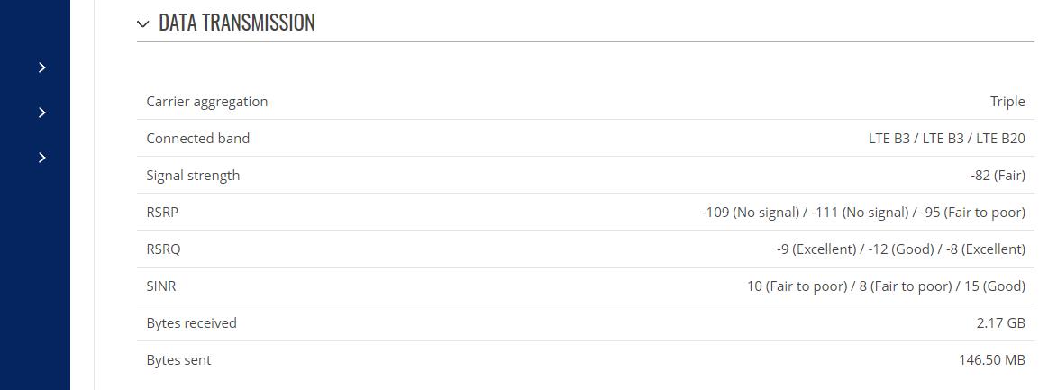

I have tripple aggregation (b20+b3+b3) with speeds up to 85mbit/s with four antennas that came with the router. However,it will randomly drop to a single b20 band,where i have no speed. And then,if i go to the settings,remove b20 band,leave only b3,add b20 again,the tripple aggregation will show up again. So,we have bugs and we have to “trigger” the aggregation by changing settings every once a while. That is bad.

The internal modem usually “settles in” onto the band that can provide the most stable connection. As the signal parameters are quite bad for B3, this makes sense. This sometimes means sacrificing some speed.
Either way, there is no definitive way to “force” carrier aggregation, however, we do have a guide for cell locking: Locking Devices to a Mobile Cell - Teltonika Networks Wiki
If you lock the device onto the band 3 that the router is connected to in a screenshot, it should keep aggregating the bands. Please keep in mind the notes in the article.

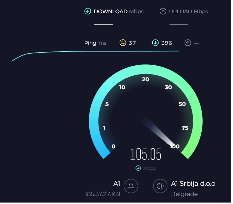

I have locked it to that one b3 band with best signal, and i get triple aggregation. The overall speed improved a lot after i added two external yagi antennas,combined with the two omni antennas that came with your ruter. Actually the speed exploded. I am satisfied, thanks.
