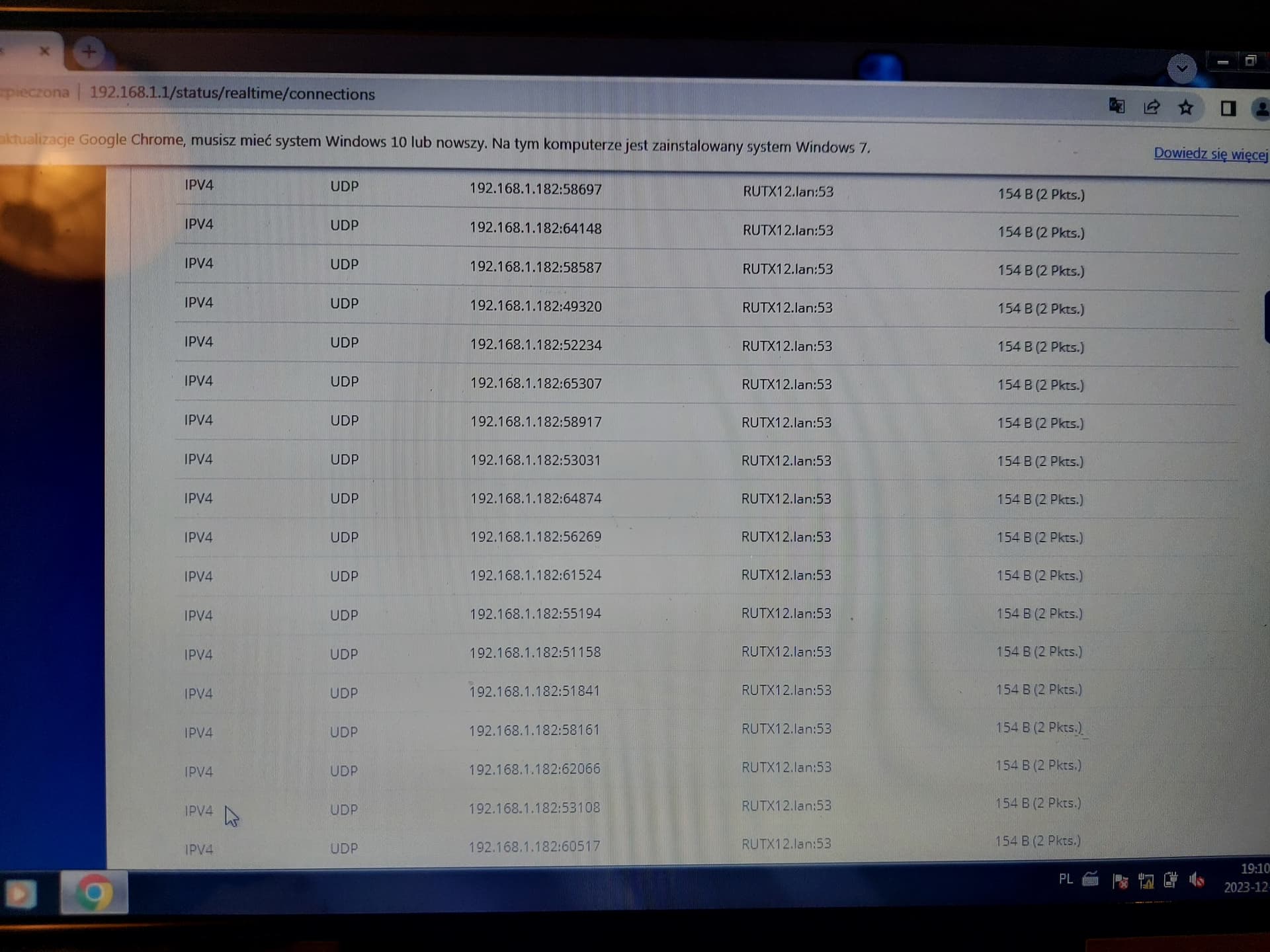

    When I first loged, I change pass, change basic option to adwance and I go to section STATUS > REAL TIME DATA> CONNECTIONS and… I see a lot of UDPs connections do my PC (peak is arround 150-300)
    Exaples down, It’s normal???

My router (RUTX12) asked any connected devices about DNS. Device (example my PC on port 192.168.0.182 answered on diffrents ports back. It gernerated inwanted traffic.
When I change rules inside router in firewall WAN ‘reject’ to ‘drop’ then traffic is little bit of lower but it does’t eliminate problem. Limit of my simcard is 10Gb. The cart is empty after 7days. I think it’s unnormal. Few monts ago is’n any problem. Limit works between months.

Based on the images, it appears that your PC is responsible for sending DNS queries to the RUTX12, which is a standard behavior. However, the frequency of these requests is determined by the number and types of applications you have running on your PC. When your PC needs to establish communication with a specific device on the internet using a hostname, it sends a DNS request to the router to translate the hostname into an IP address. Your PC employs a random ephemeral port number (ranging from 49152 to 65535) to send this DNS query to the DNS service (on port 53) hosted on your router. In summary, your PC is the source of this network activity, and its intensity depends on the applications in use. It’s worth noting that some legitimate applications may initiate this traffic, but it could also indicate the presence of malware. It is hard to say without inspecting the traffic whether these are legitimate requests or not.
