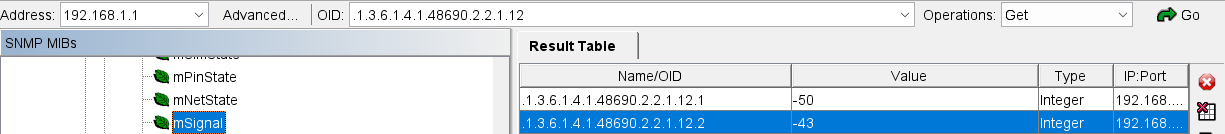

RUTX is configured in a way that if both SIM cards are active, the MIB viewer will display information for the selected OID for both modems. Here is an example:
Or you can target each modem directly by adding .1 or .2 at the end of OID.
