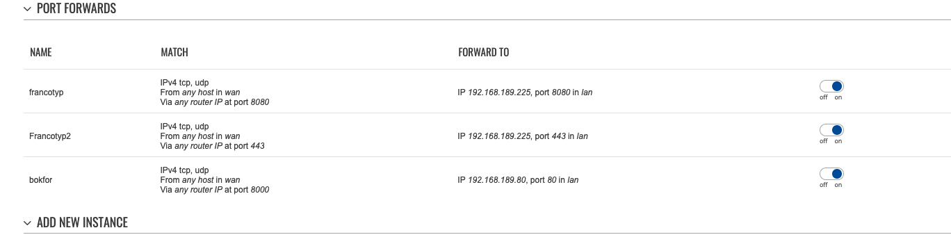

I need to be able to connect from inside the LAN to external server, bidirectionally, using port 443 and 8080. This is denied despite I have opened “port forward”. In other routers port forward is one thing and opening ports another so it doesn’t feel right using “port forward” for connections initiated from the inside of the LAN

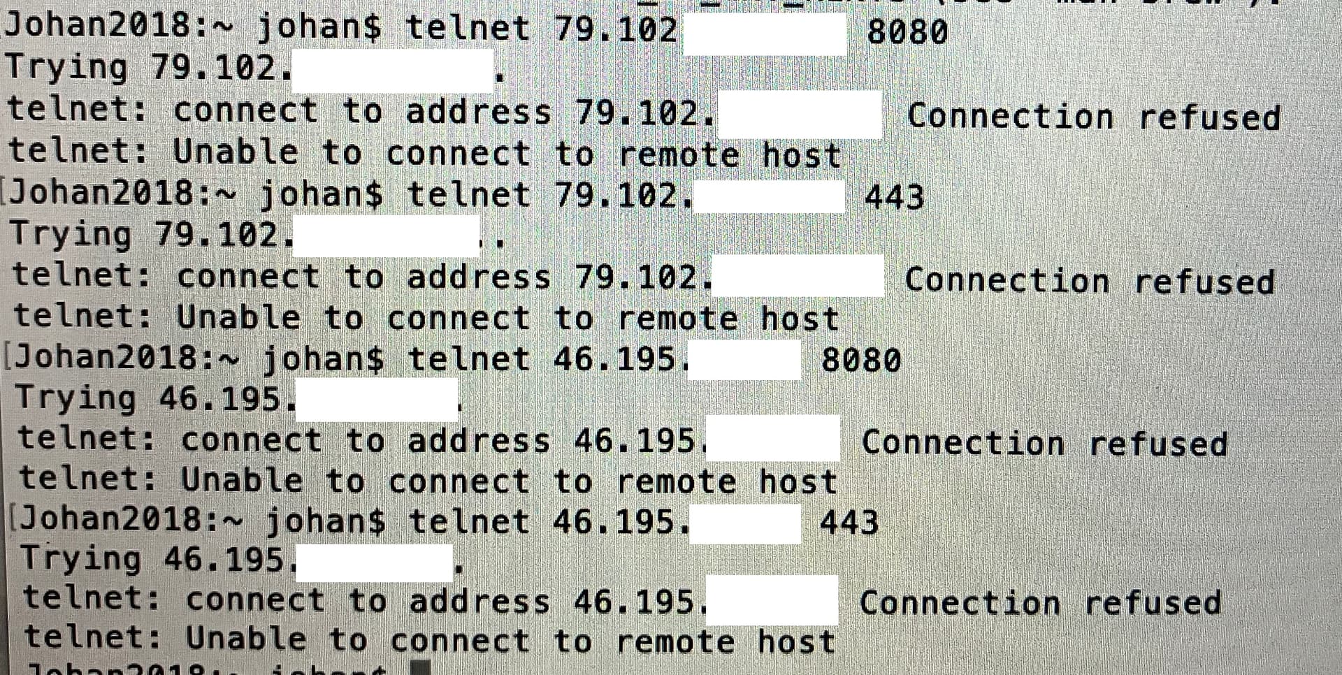

If you have a device that operates outside the RUTX12 LAN (and is not connected via ZeroTier), could you try running these commands via the command line (CMD for Windows, Terminal for Linux and Mac OS) and post the results:
telnet 46.195.xxx.xxx 8080
telnet 178.31.xxx.xxx 8080
telnet 46.195.xxx.xxx 443
telnet 178.31.xxx.xxx 443
Of course, use the full IP addresses when running the command and blur them out when posting the output.

I will check the results when telnet-ing to the router from outside.

Now I have been able to test again.
Outbound trafic (from LAN to WAN i.e.) works as I mentioned after reducing the packet sizes.
inbound traffic are still refused.
I also have a port forward rule on port 8000 → port 80 on the server I can reach using zerotier, but the connection is refused there too when I try a web browser.
So the problem with opening ports still persists, I’m afraid!
Could you clarify if you have created a rule to open port 8080, or 8000?
Perhaps for testing purposes you could configure the DMZ (Network → Firewall → DMZ) to redirect all incoming traffic to 192.168.189.225?
The server is on adress 192.168.189.80 so the port forward from 8000 → 80 should reach it but it will not.
The two port forward rules on .225 I leave as that part works now, although I don’t think those make any difference.
I made DMZ to the server on adress 192.168.189.80 with no difference. I still think there is some kind of problem with the firewall on rutX12…

On Rut241 the setting is for failover and port forward from port 8000 (wan) to port 80 (192.xxx.xxx.xxx) and it works
Similar settings on rutX12. Access is denied and nothing forwarded.
According to what is said I have changed away from failover to load balancing but all trafic is still denied and nothing forwarded!
