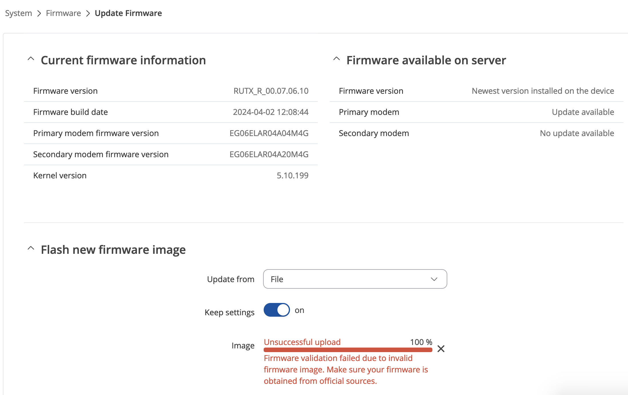

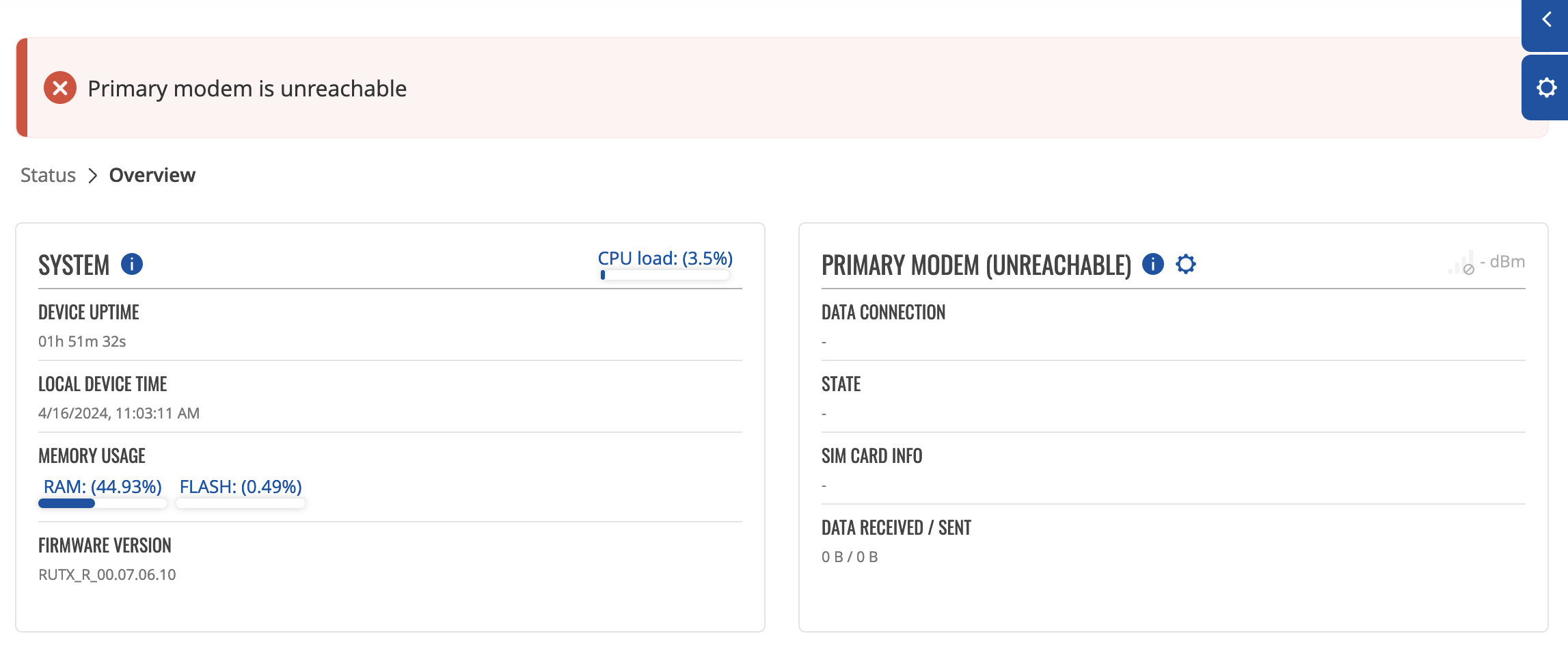

It seems that the main issue might be modems being unreachable. If modems are unreachable, connections can’t be made, and upgrades can’t be performed. Can you establish a mobile connection using either of those modems?

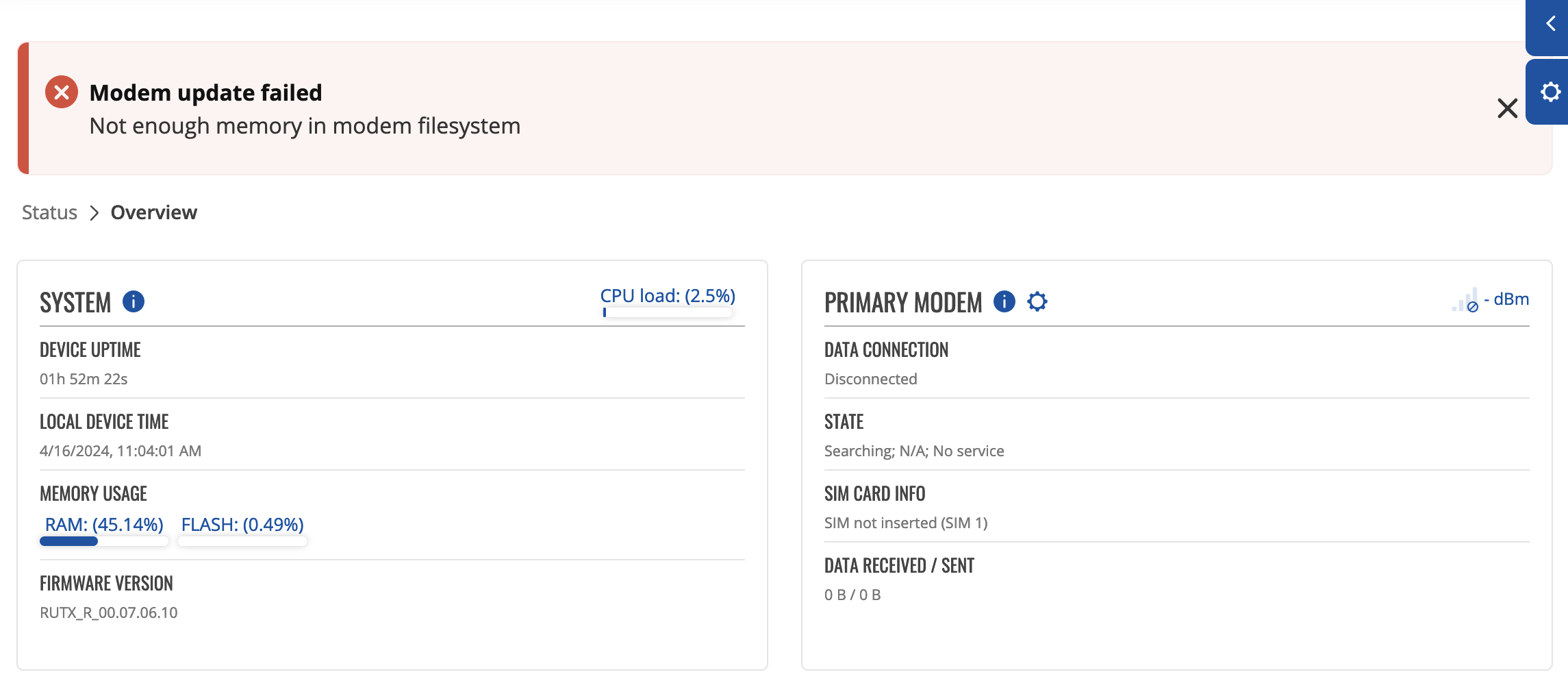

I inserted a working SIM, but the primary isn’t recognizing it in any way… I will try a different SIM but I have the feeling that the modem could be broken.

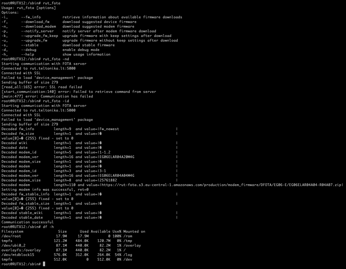

Is there another way to check it, through ssh or something?
The modem may be broken. To check this, you can try factory resetting the device (make sure to take a backup if any important configuration settings are present ) and then check again. If the issue persists, it’s likely that the modem has failed and needs to be replaced. In that case, you should contact your reseller or Teltonika if you bought directly from us, and we’ll initiate the RMA (Return Merchandise Authorization) process.
Additionally, the device may not connect with a modem on startup in some random cases. You can try restarting your device a few times to check if this might be the case.
