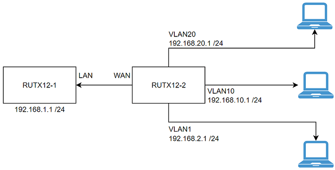

For me to assist you better on this, can you share with us a topology containing the devices and subnets? I am also requesting this to recreate your case locally. Looking forward for your response.

As per topology above, I tried to recreate your network by putting a RUTX12-2 as a Mikrotik Switch. I configured multiple VLANs to have different subnets. RUTX12-1 would be providing Internet to RUTX12-2. When connecting to the end PCs, they are able to connect to the Internet without any further configuration.
Let me know your results!
