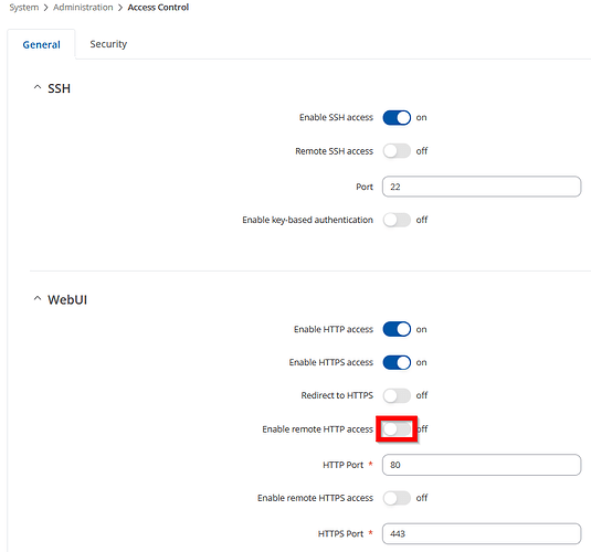

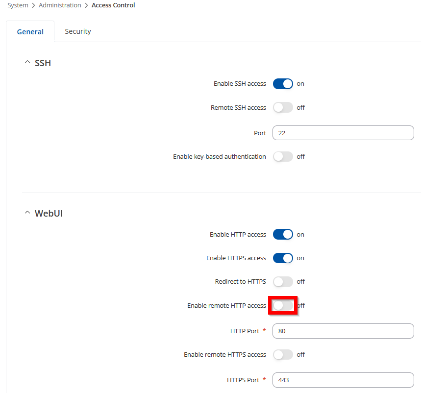

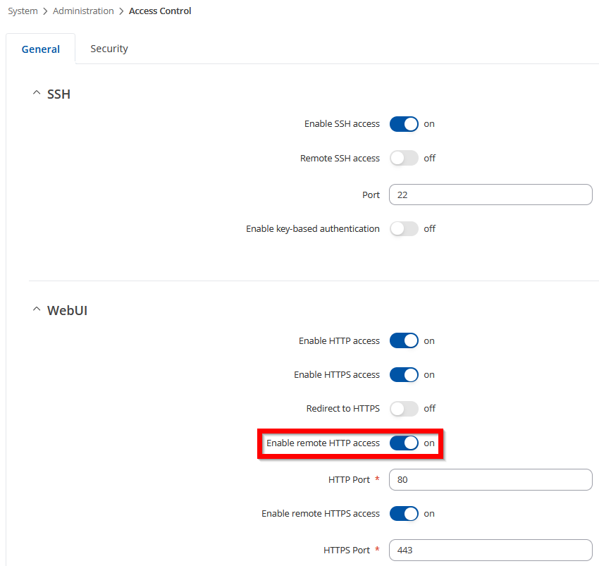

It seems you’d like to make Port 80 accessible for remote connections. To achieve this, follow these steps:
  • Navigate to System → Administration → Access Control.
  • Enable the “Enable remote HTTP access” option.
By doing this, Port 80 will now be accessible externally.

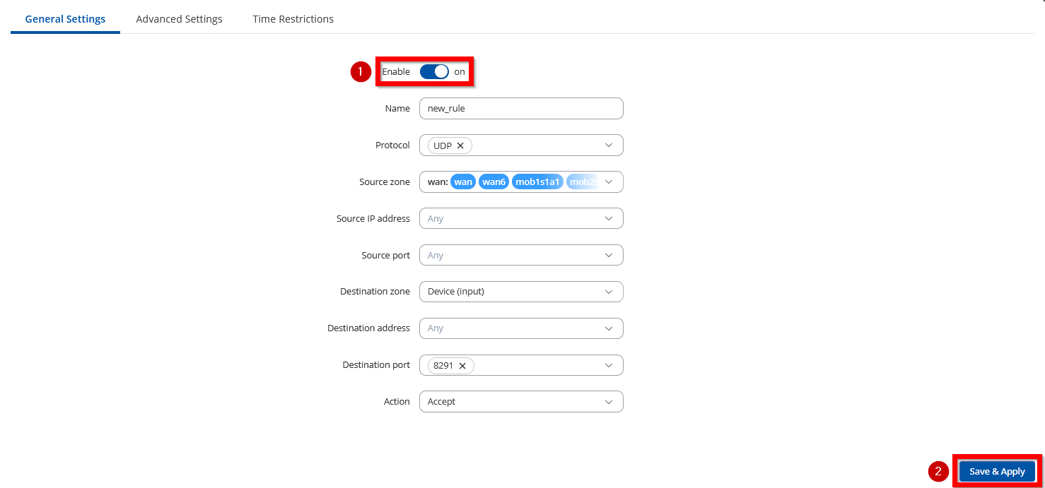

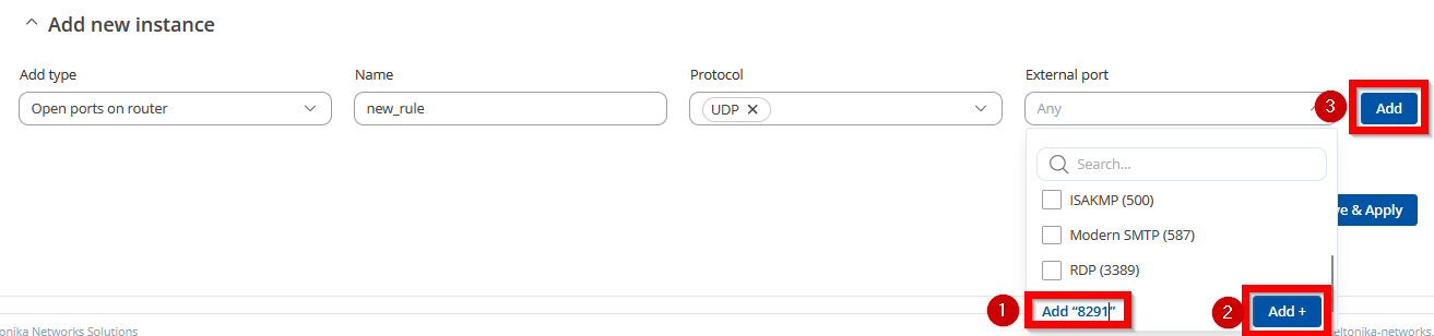

Here is a quick tutorial on how to open port 8291 on your router for WAN access:
  1. Navigate to Network → Firewall → Traffic Rules.
  2. Scroll to the bottom of the page and configure the rule as shown below.
  3. In the next pop-up menu, enable the rule and save it.
By following these steps, you will create a new rule for opening the specified port.
