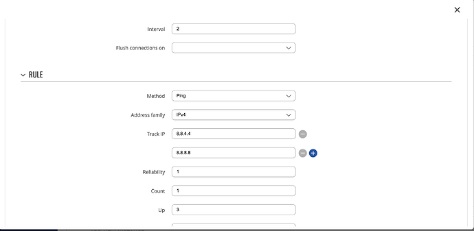

When WAN loses connection it does mot failover to modem.
I see on the wiki one should use 1.1.1.1 and 8.8.8.8 for track ip. The WAN on mine is set up like this:
Could that be causing the problem?

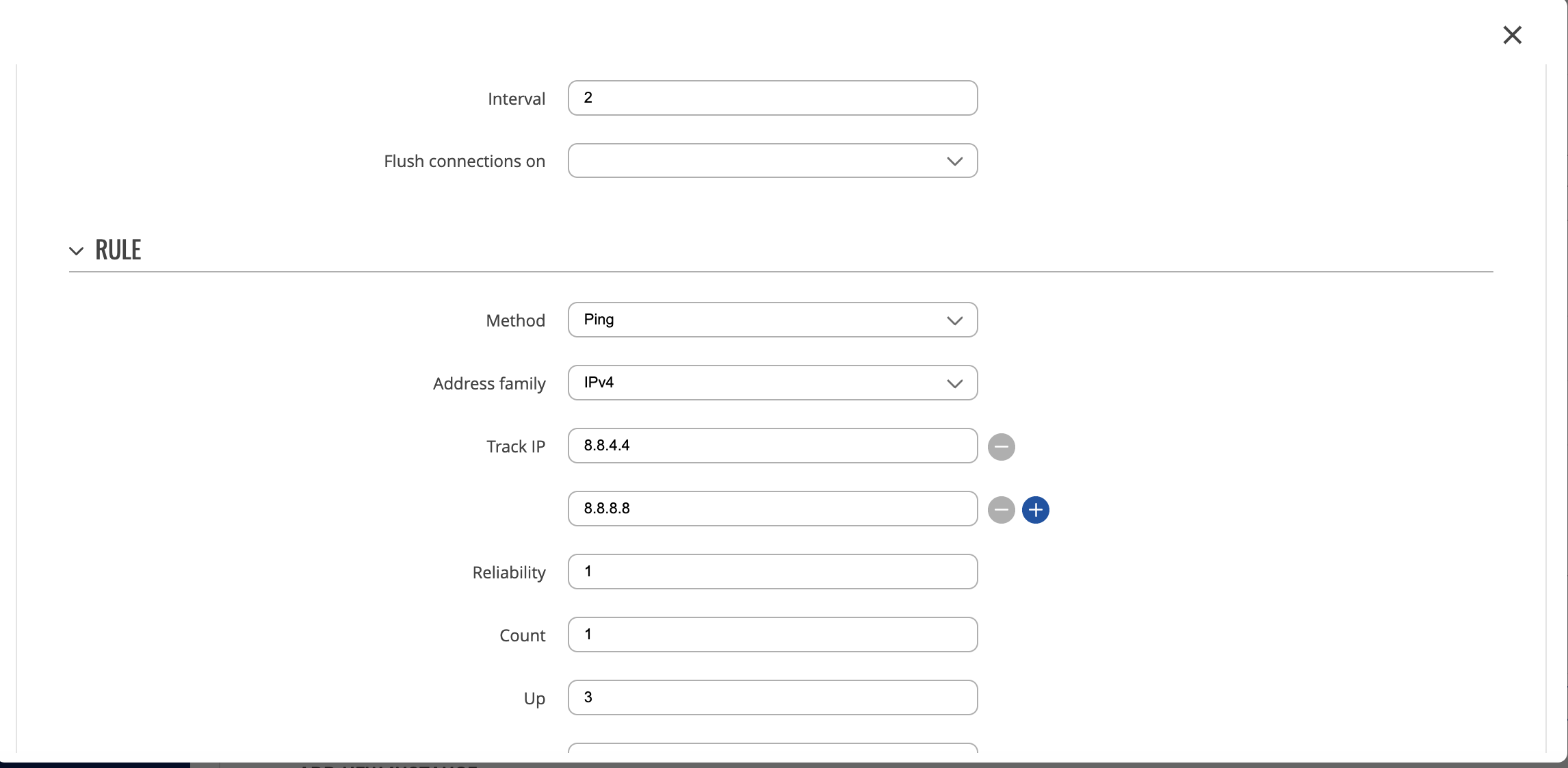

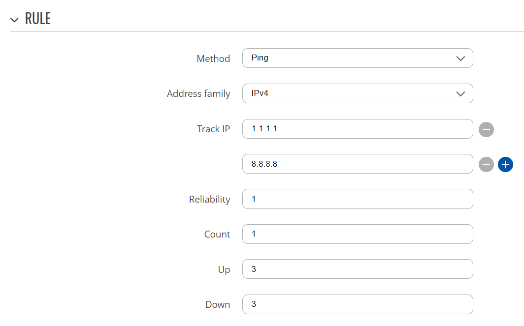

Thanks for reaching us.
By default, the Track IP is set to 1.1.1.1, 8.8.8.8 as this is the DNS server for internet connectivity; in that case, I would recommend changing it to the default one 1.1.1.1, 8.8.8.8 as shown in the screenshot below

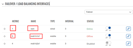

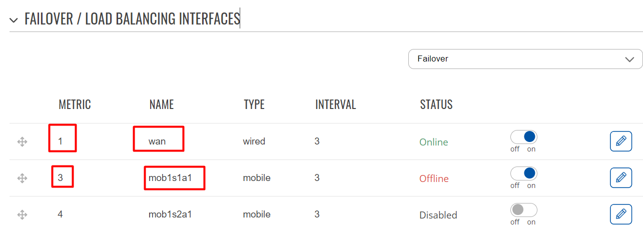

You must also set the priority for the failover interfaces, as shown in the screenshot below
More on this link: RUT955 Failover - Teltonika Networks Wiki
