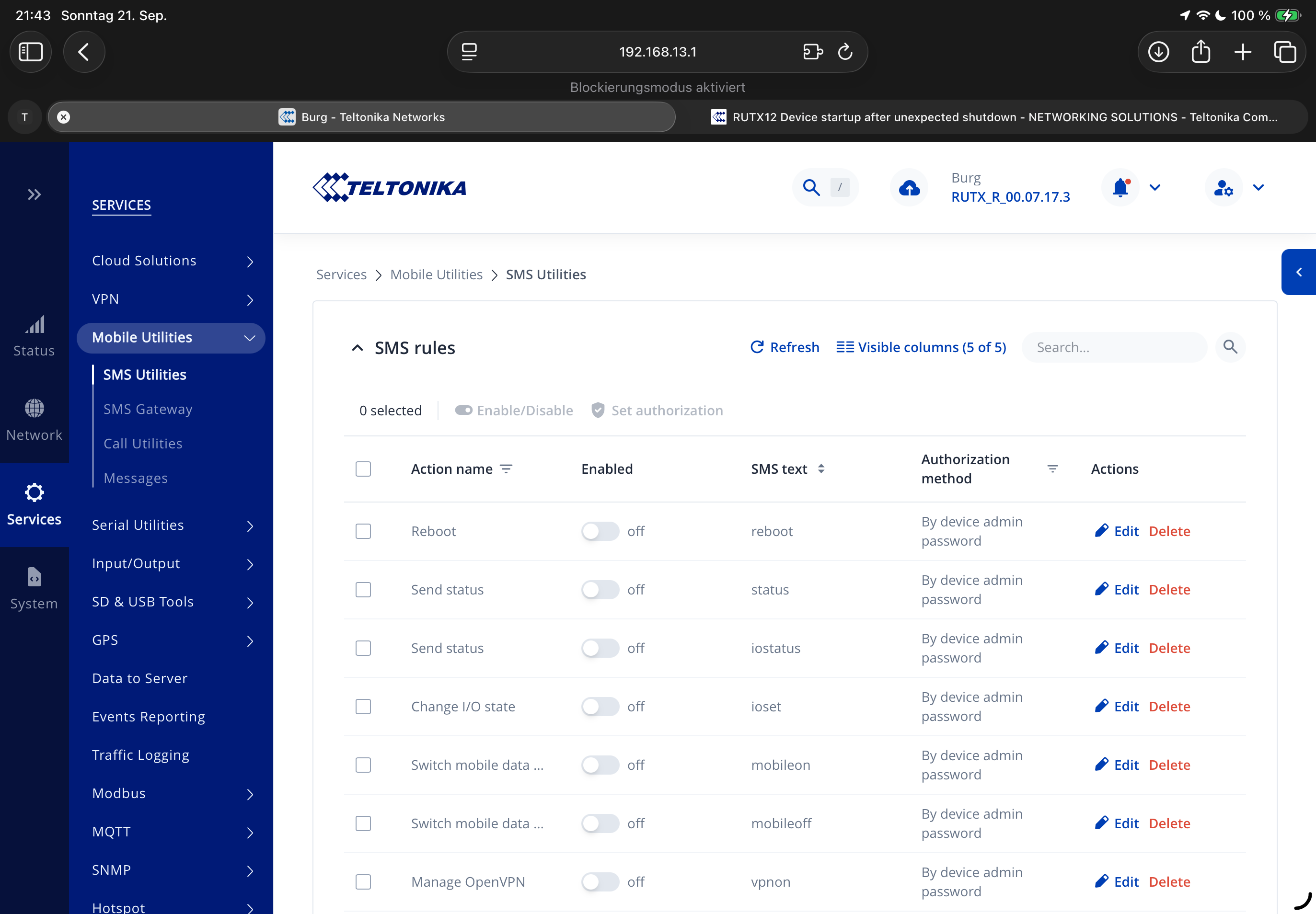

SMS messages were set to enabled but the message log shows no recent messages. I have turned off SMS rules now. I’ll monitor the status and post back later this week.

Ping/Wget Reboot & Reboot Scheduler are turned off. I have also disabled SMS Utilities as mentioned by Florit. Unless there’s any other default settings that could cause a reboot there should be nothing else triggering them.
