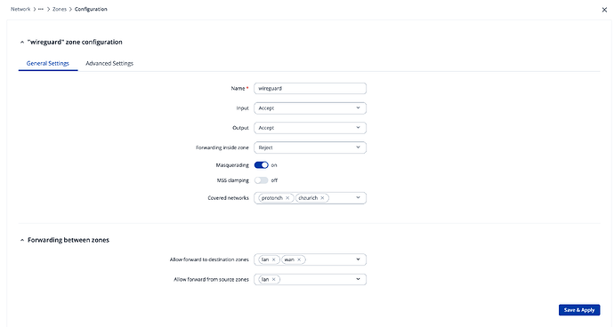

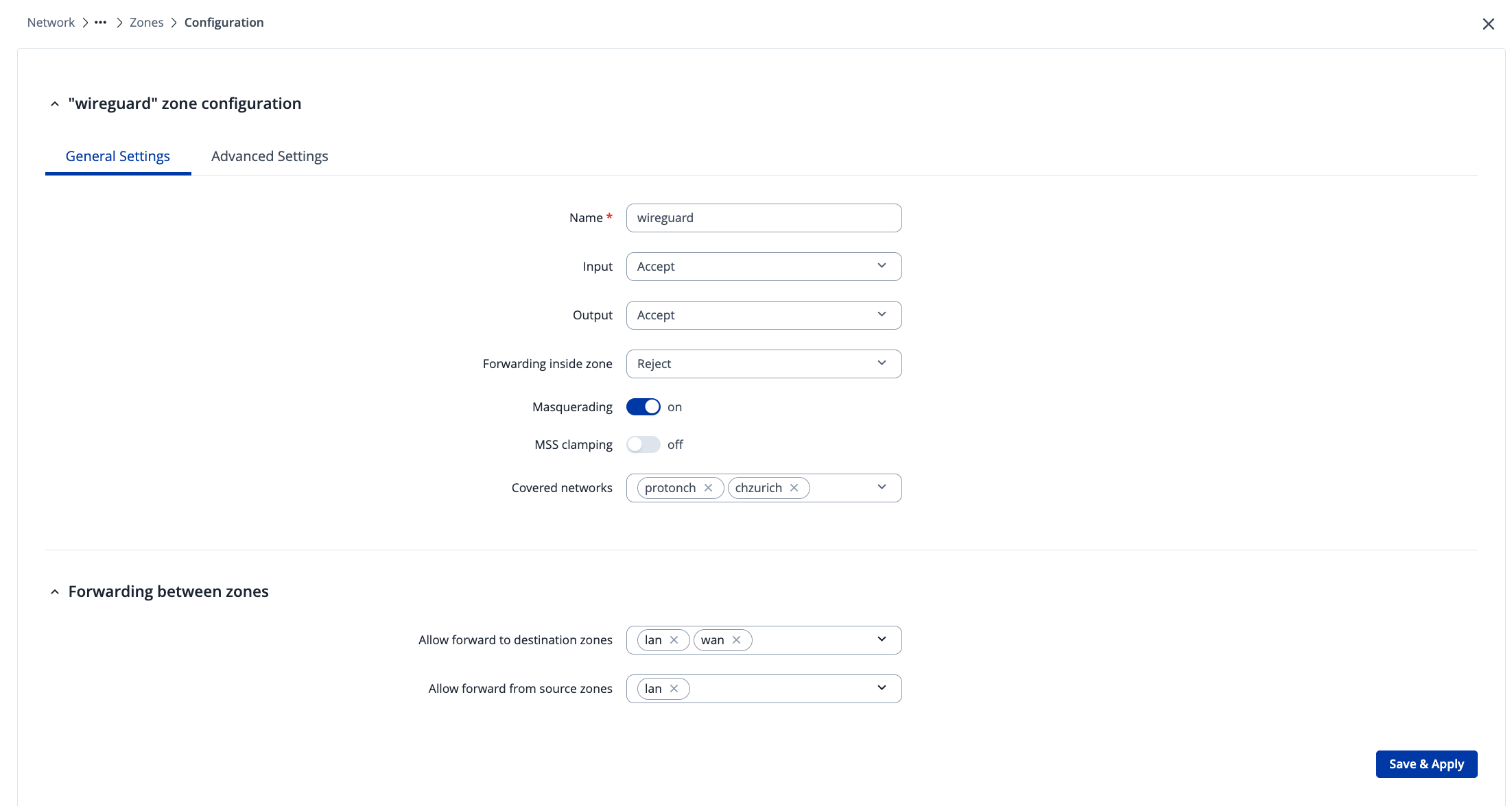

We tried doing a setup as close as possible to yours and this is what we came up with:
  1. Instead of using the static routes / policy based routing, we simply added 0.0.0.0/0 to the Allowed IPs list under the Peer Configuration on the WireGuard Client device.
  2. We then went to Network → Firewall → Zones and we edited the firewall zone that is Wireguard => LAN:
    And added the WAN zone to the Allow Forward to destination zones:
This ended up:
  1. Routing ALL the traffic through the tunnel
  2. Providing the clients internet without any issues
  3. We tested this with VLANs included and saw the same results

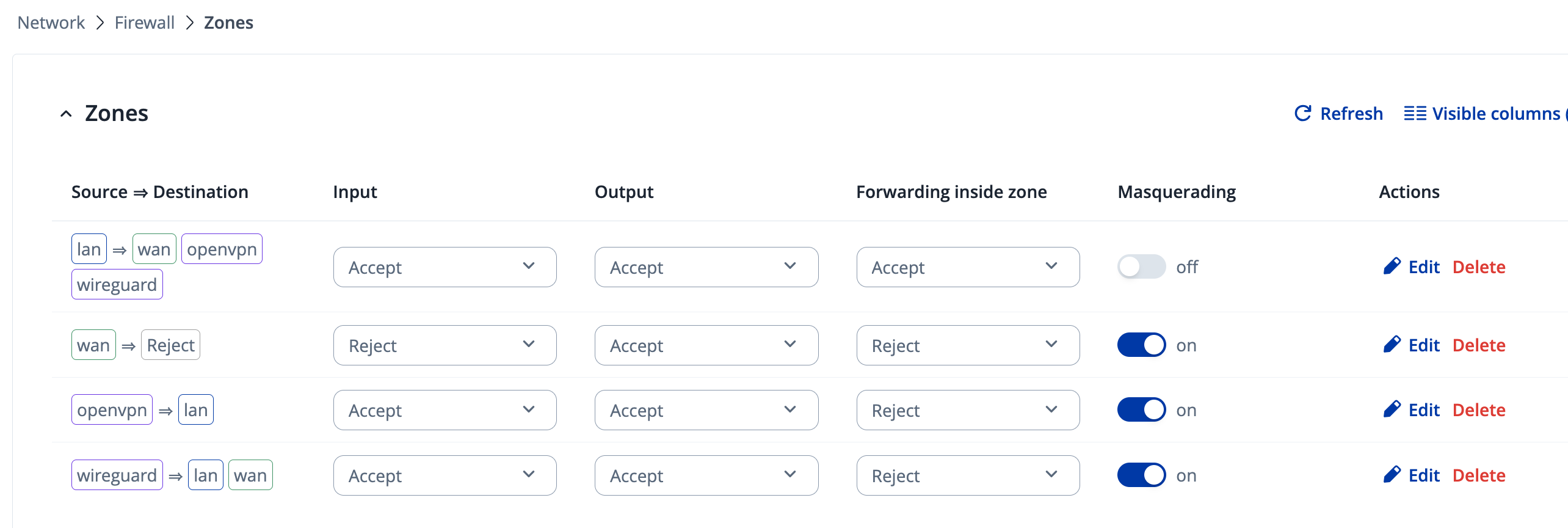

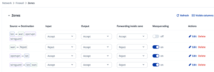

So routing reachability is correct and return paths exist. I also confirmed that packets are forwarded out of eth1, which means routing decisions are being made correctly.
Where the failure occurs
The failure happens before routing selection, at the firewall/NAT stage.
I verified this with packet captures:
  • On br-lan, I see traffic from 192.168.240.206 → 8.8.8.8
  • On eth1, I also see traffic leaving the router, but with source IP still 192.168.240.206
  • The traffic is therefore forwarded but not NATed/masqueraded, and the upstream gateway drops it
When I manually add:
iptables -t nat -A POSTROUTING -s 192.168.240.0/24 -o eth1 -j MASQUERADE
traffic immediately works, which strongly indicates a NAT / firewall zone classification issue rather than a routing issue.
