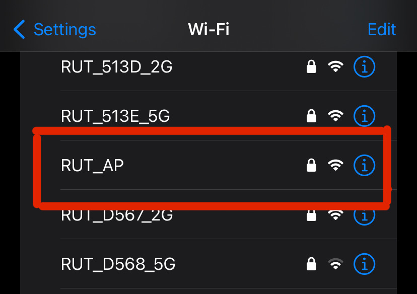

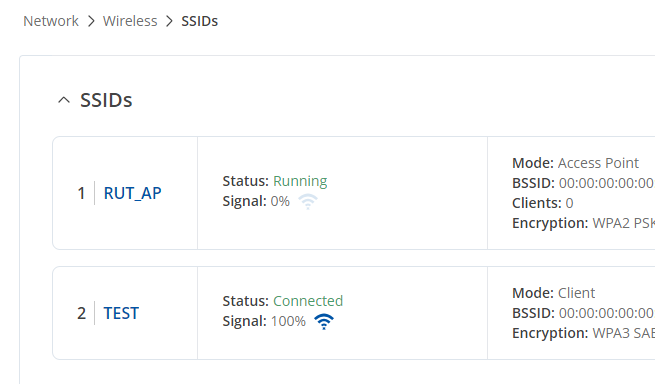

Regarding the wireless setup, I’ve conducted a test:
  1. I created an SSID named ‘RUT_AP’ in Access Point mode.
  2. I scanned for wireless networks and connected to another device’s WiFi named TEST, setting that SSID mode to ‘Client’.
3.Now, my RUT device has internet access via WiFi, and it’s also broadcasting a different SSID acting as an access point. I can confirm this by checking available WiFi networks in my phone settings.
Could you please double-check if you’ve completed all the steps correctly and try setting up the connection again?
If everything has been done correctly, the issue might be related to the firmware. I highly recommend upgrading your RUTX11 firmware, and please let me know if you encounter any further issues!
