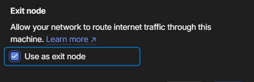

Having issues with making a RUTX11 function as an exit node in tailscale. Exit node is enabled and approved in the tailscale admin dashboard, but it seems like the Teltonika is either breaking the route somehow, or there is a firewall rule I cannot find thats blocking the connection.

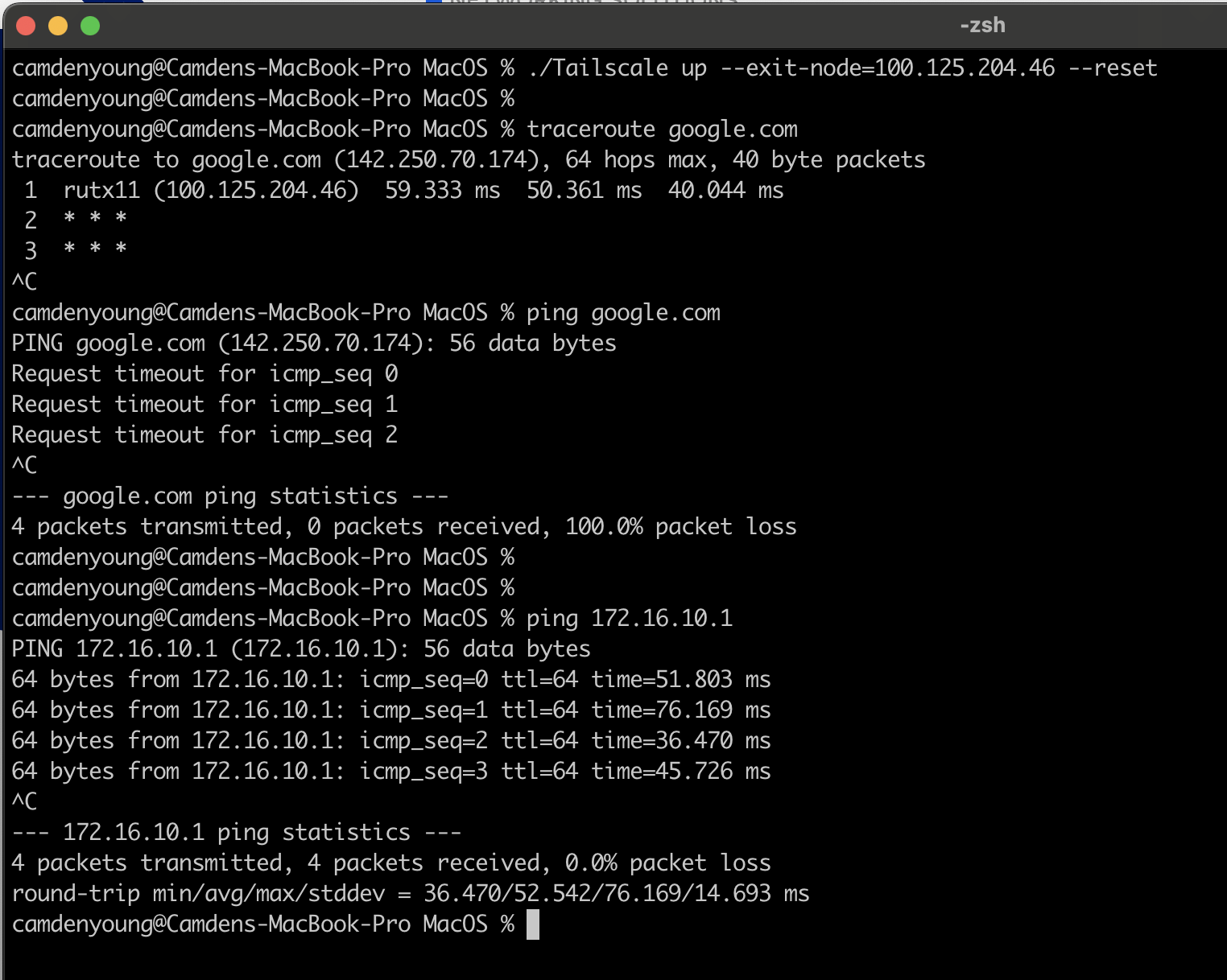

On a client device set to use the RUTX11 as an exit node, traceroute shows that traffic is indeed going via the rutx as its first hop, but fails from there. nslookup shows that dns is going via the tailnet too. If I try and ping an external ip directly, it fails, so there is either a routing issue, or firewall… anyone had success with this? Teltonika is running latest firmware.

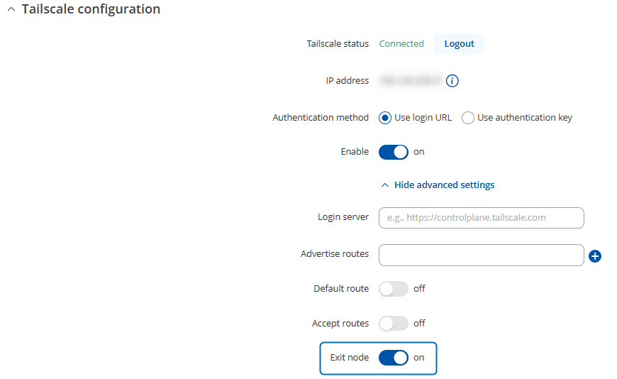

Unfortunately this still doesn’t work. I appreciate the steps listed, but that is the setup already in place. For clarity, please see the following screenshots.

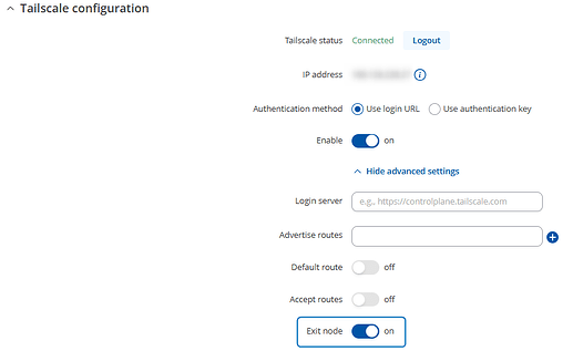

Exit Node Enabled on Rutx11

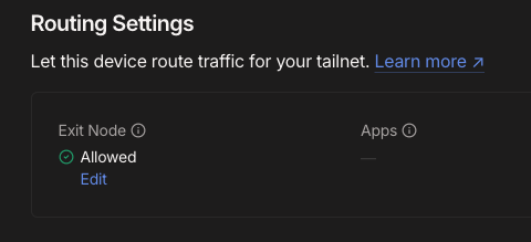

Exit Node Authorised in Tailscale Admin for the Rutx11

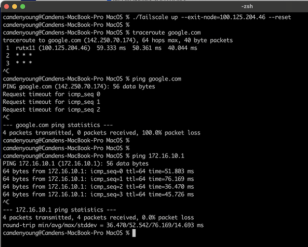

The next terminal screenshots shows the following:
  1. Running the CLI command to set the exit node on the client.
  2. A traceroute showing that the first hop is going via the rutx (via tailscale), but then fails to route any further.
  3. Showing a ping to the outside world does not respond.
  4. Finally, pinging a local subnet at the Rutx11 side, which shows there is successful connectivity between local subnets.

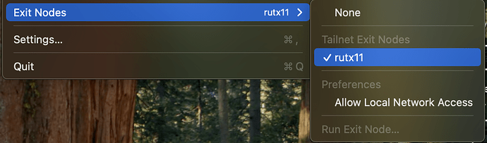

And finally, to show the CLI command was succesful, below is a screenshot from Tailscale’s MacOS GUI showing the rutx11 is selected as the Exit node on the client machine
