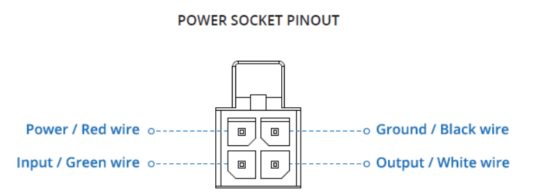

Does anybody know what the input and output pinouts are used for on the 4 pin power supply for the RUTX11 as seen here:

Here you go
Yes, but what are the Input and output pins for?
I’d like to start by clarifying that DI/DO (Digital Input/Digital Output) functions are not related to powering up the device.
Digital input is designed for collecting data from various sensors and devices. For instance, in environmental monitoring, digital inputs can be employed to gather data from temperature sensors, humidity sensors, or motion detectors.
Digital output, on the other hand, is used to send digital signals to other devices or systems and can trigger alarms and notifications in response to specific events or conditions.
For additional information on RUTX11 input/output functionality and its capabilities, please refer to our wiki page: RUTX11 Input/Output - Teltonika Networks Wiki
Regarding your power-related issue, it’s unusual for the device to exhibit this behavior. To troubleshoot the problem, if possible, I would recommend trying a different power supply. It’s possible that the current one may be experiencing some issues. If trying a new power supply does not resolve the problem, I recommend considering the last-resort recovery option. This involves putting the router into bootloader menu state and attempting an update from there. You can find detailed instructions on how to do this here: Bootloader menu - Teltonika Networks Wiki
If the bootloader does not resolve the issue, please contact your supplier from whom you purchased the device and inquire about the possibility of an RMA (Return Merchandise Authorization).
