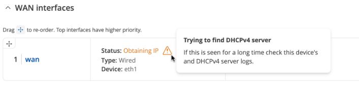

I am getting an orange ‘Obtaining IP’ message on the WAN port of my RUTx11.
I have the RUTX11 WAN port (DHCP) connected to a TP-Link VR-1800v modem in bridge mode. I expect the RUT to pick up the dynamic IP from the ISP as the ISP requires dynamic settings. The RUT fails to get any IP from the ISP.
