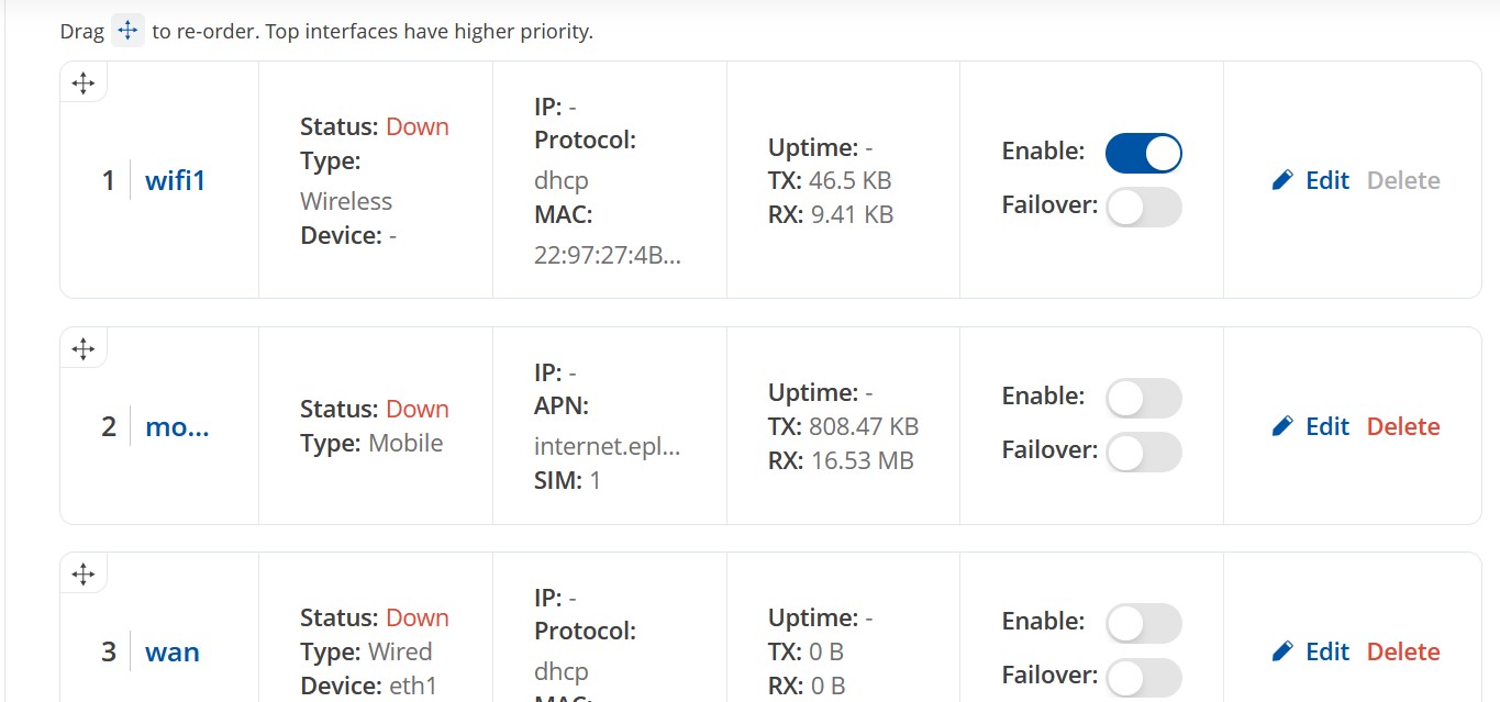

I have a RUTX11 on my sailing vessel installed 3 month ago and everything went very well.
Access to the harbor wifi and SIM happened all the time,failover working great.

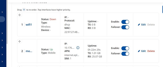

8 days ago, the wifi access collapsed and never came back, irrespective new configuration, new firmware or a total reset.

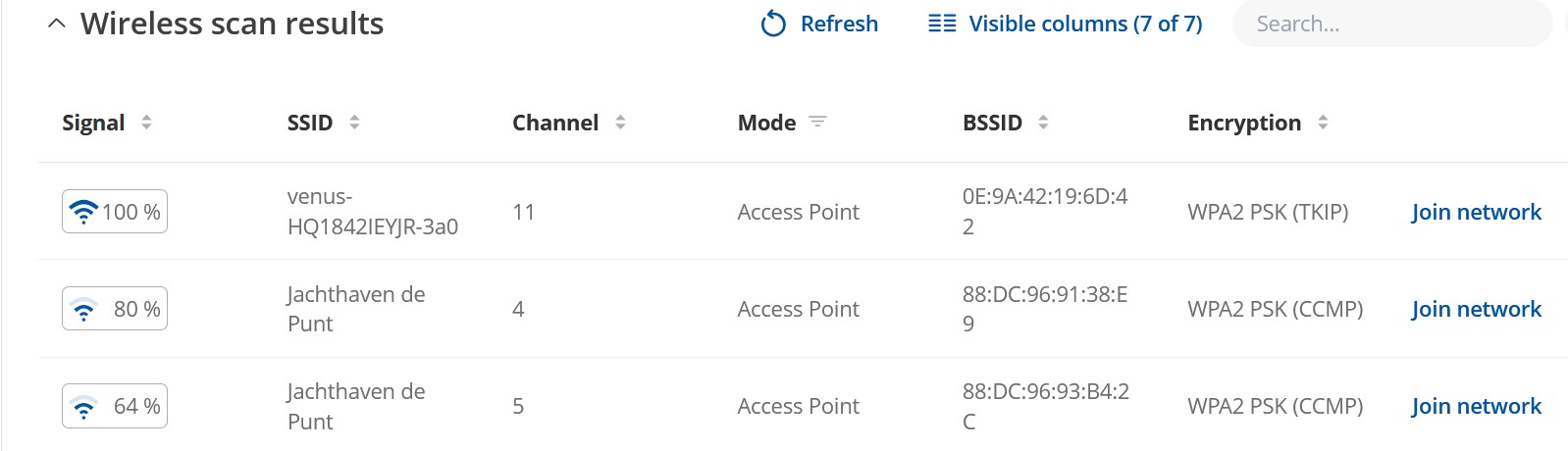

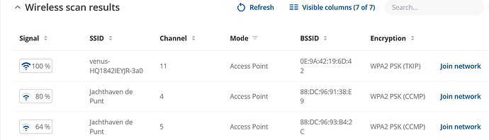

This evening, the wifi connected shortly after a couple of hours but chnged back to swap between idel and searching, but on the wan site the SSID kept down, so no internet, even though the scan can find it easily.
RUTX11 firmware RUTX_R_00.07.14.3
Any help is very much appreciate.
Screenshots are available if of interest.

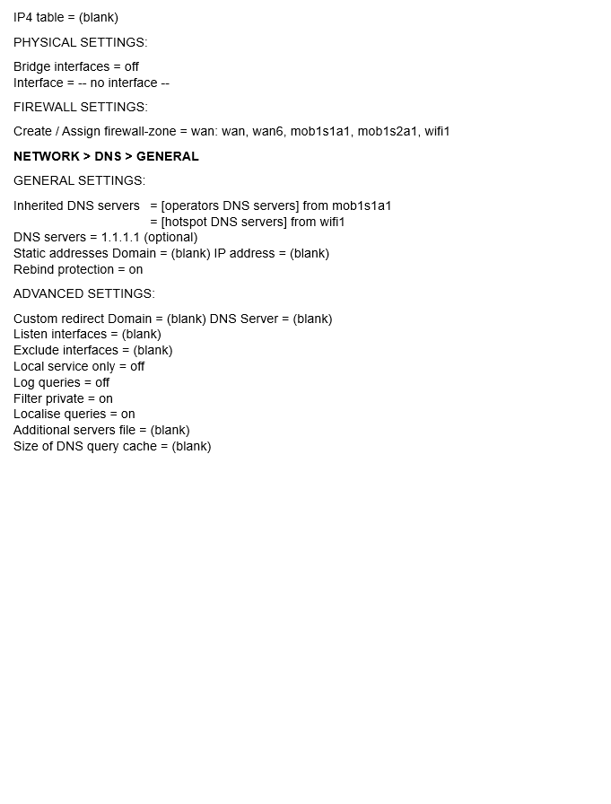

In very rare instances (the harbour / supply chain may have made infrastrucure changes), you may have to disable rebind protection. With rebind protection on, the router discards upstream responses that return a private address i.e. discards upstream RFC1918 responses. When enabled, the device will not resolve domain names for internal hosts. Find this at NETWORK > DNS > GENERAL. If this doesn’t make any difference, then it’s better to leave rebind protection on, for secure purposes.

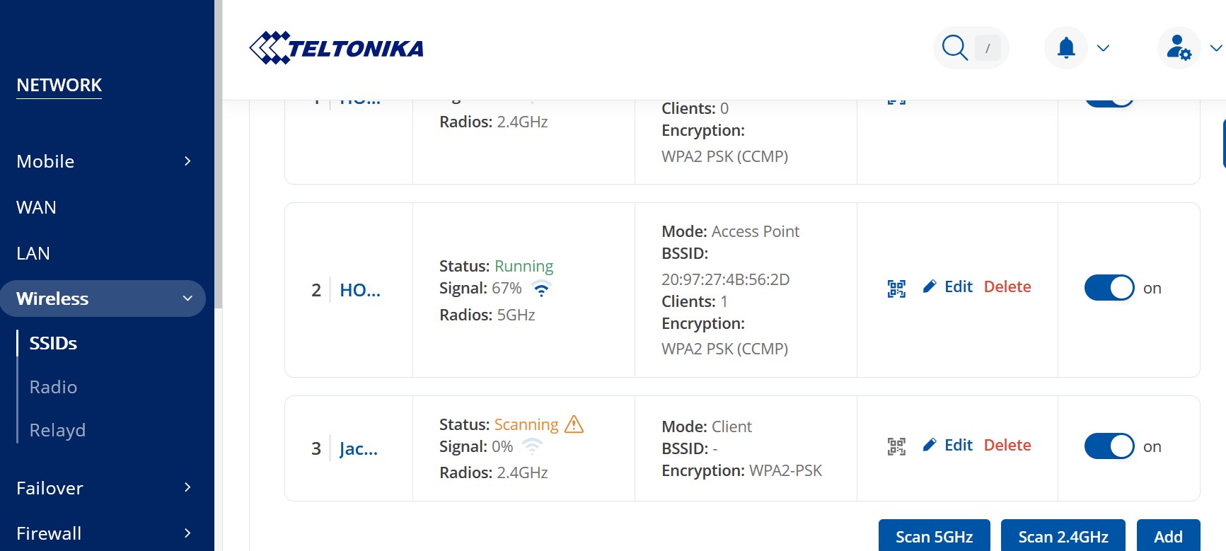

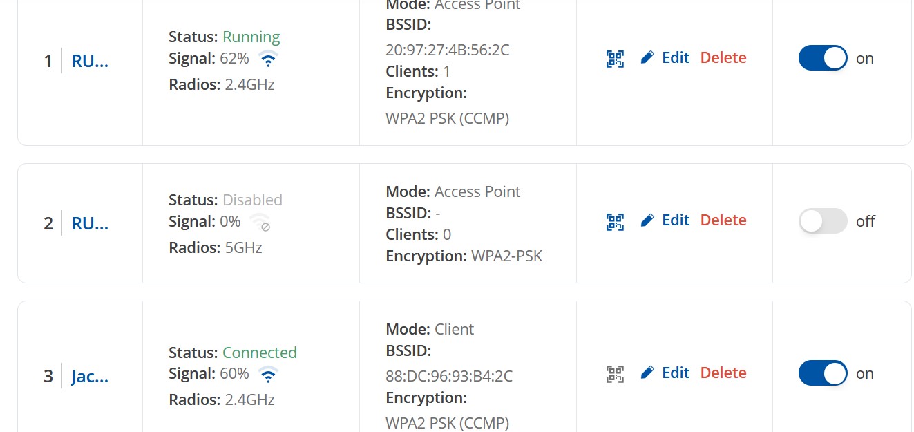

So I did a reset to factory setting at web gui; at least I got a conection to the harbor wifi, and RUT wifi shows as running, but still no wlan.
Harbor wifi is running on iphone and ipad.
I see you are still running two SSID’s on 2.4GHz - we only want the ‘jachthaven’ SSID running on that frequency. You can enable the 5Ghz SSID for devices to connect to your router.

At NETWORK > WAN > wifi1 > PHYSICAL SETTINGS … I believe that ‘Bridge interfaces’ should be ‘off’, and ‘Interface’ should read ‘-- No interface --’

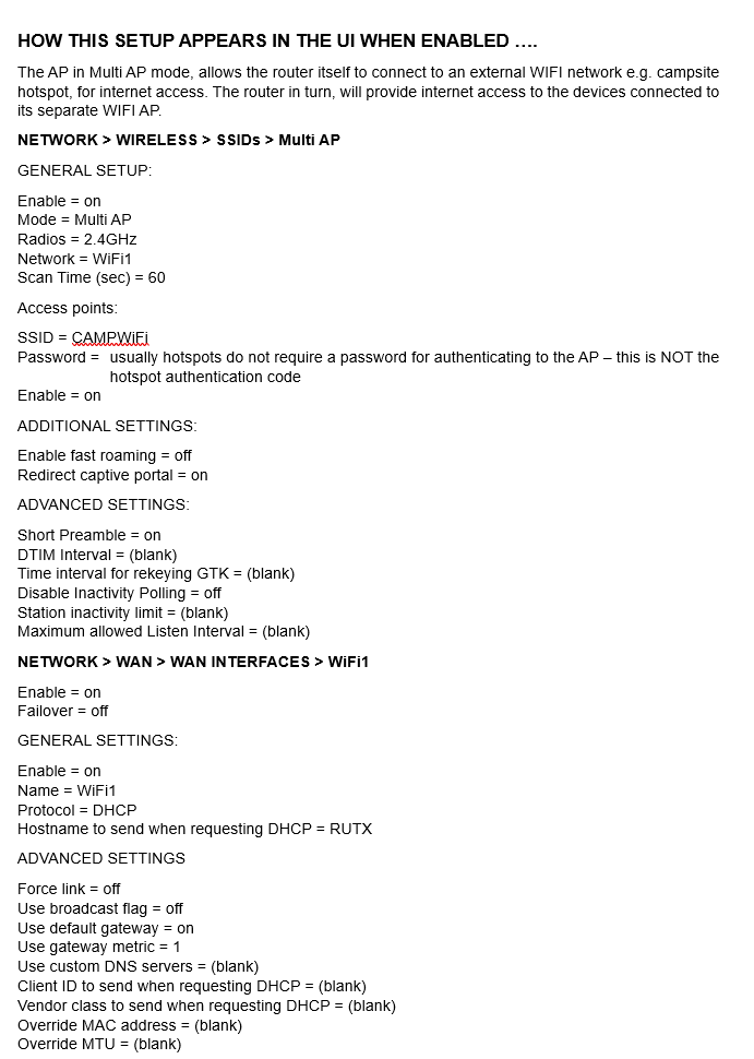

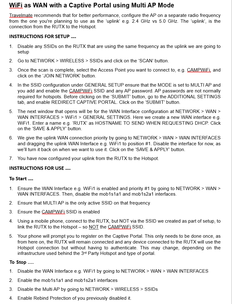

That’s about all I can suggest other than you could try ‘Multi AP’ mode, see below … rarely, after you have turned on the Multi AP SSID and the WiFi1 WAN interface, the router needs a reboot for them to take.
Multi AP mode is great for when you have to hook up to many different SSID’s when you travel around, as you can enter the credentials, and they’ll always be in the router.

I then followed your MultiAP settings and were able to find a different wifi that I am now connected with.
