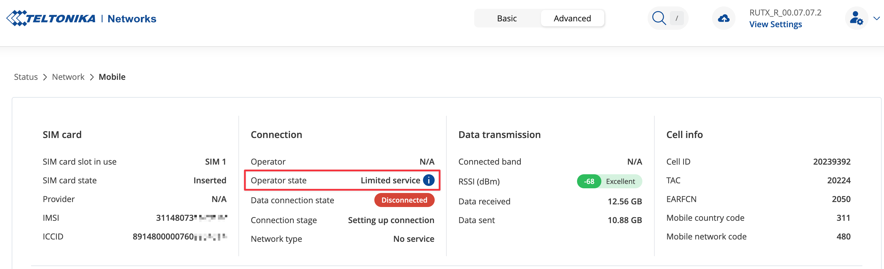

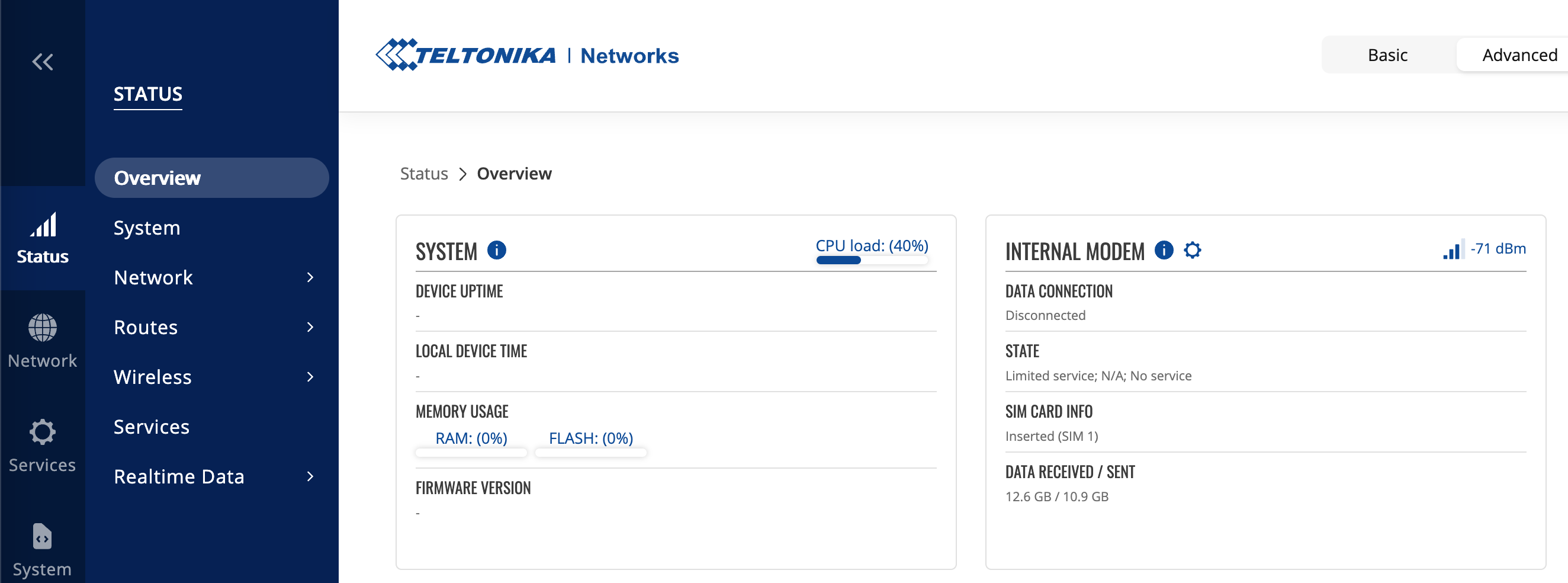

RUTX11 - "Limited service"
Never seen this before. Has anyone else?
Carrier (Verizon MVNO/US Mobile) says the device IMEI and ICCID are not blocked, blacklisted etc. It happened this morning when firmware was at 7.07.1. I installed 7.07.2 just in case, but the problem persisted. I’ve also clicked the “Restart Connection” button a couple of times.
I’m not physically close to this location so I am unable to check for antenna damage right now. This RUTX11 is using an external (outdoor) antenna connected via a 50ft RP-SMA twin cable.
The service re-established itself about 6 hours later. Maybe the cell tower was undergoing maintenance. The antennas were inspected and no damage was noted.
