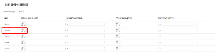

I’d suggest making sure that GPGGA forwarding is enabled:

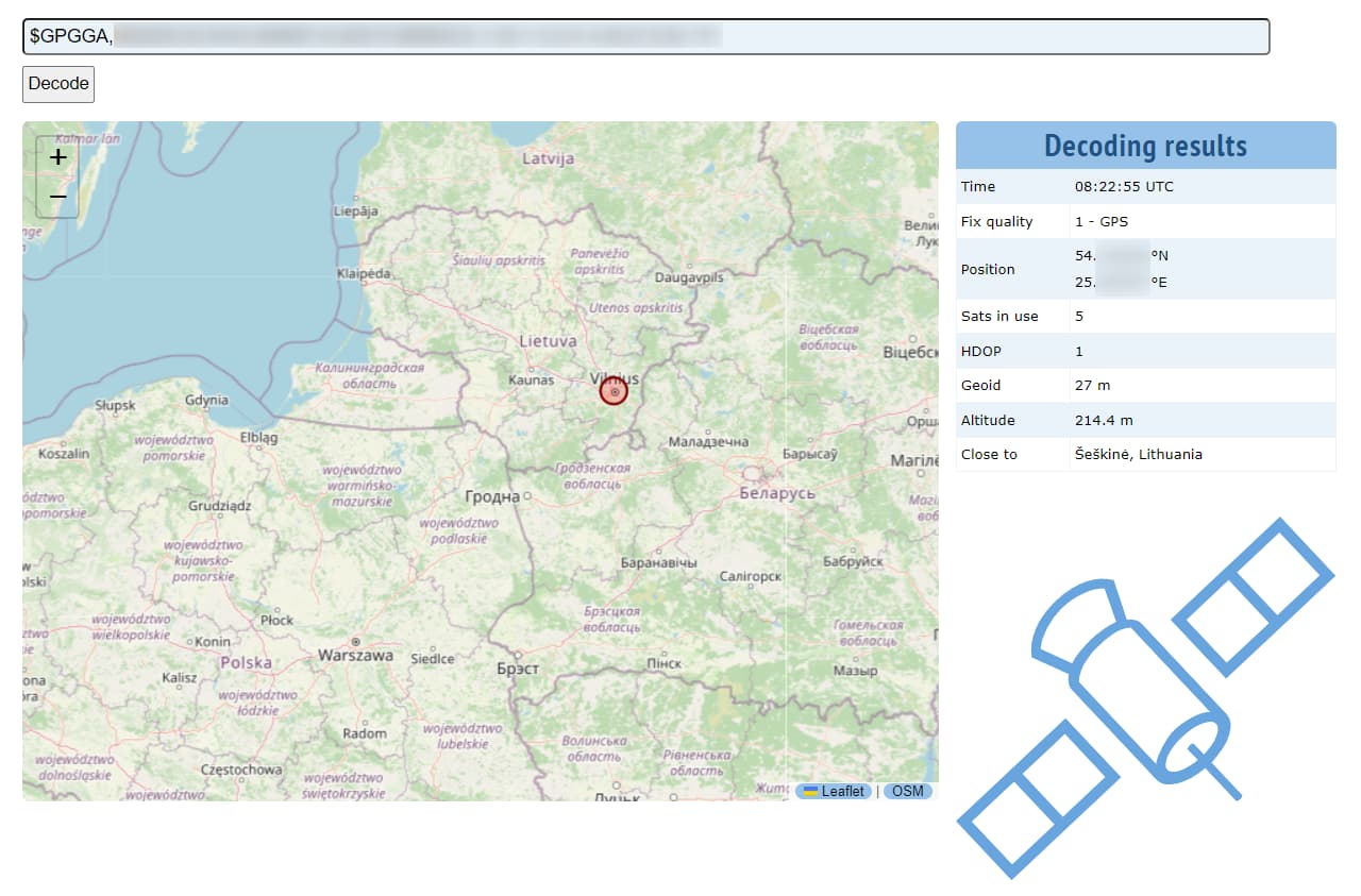

After a few seconds, stop the output by pressing Ctrl+Z and check if any GPGGA sentences are available. They can be decoded using this tool: https://rl.se/gprmc

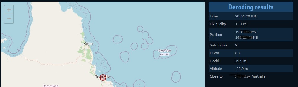

I was forwarding the GPGGA sentence, when I decode it, I get the same as I do in the Expedition navigation software.
However the GPS fix type is 2D (using the GPS receiver in my AIS Vesper XB8000 I get 3D)
Also the altitude is a negative value (I am st sea level)
The router is in a QSpot using its antenna for GPS.

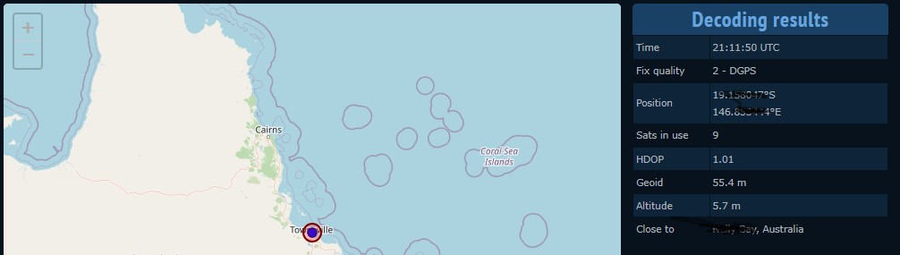

And here is the decode when using GPS source as the Vesper XB8000.
This has a fix quality - 2 DGPS
My initial post refers to this difference - can the RUTX11 GPS provide a type 2 DGPS fix?
Apologies, I believe I misunderstood your question.
Indeed, our devices only support GNSS constellations, thus only 2D fix can be acquired. Differential GPS requires specialized equipment and would most likely be out of the scope for a router.
