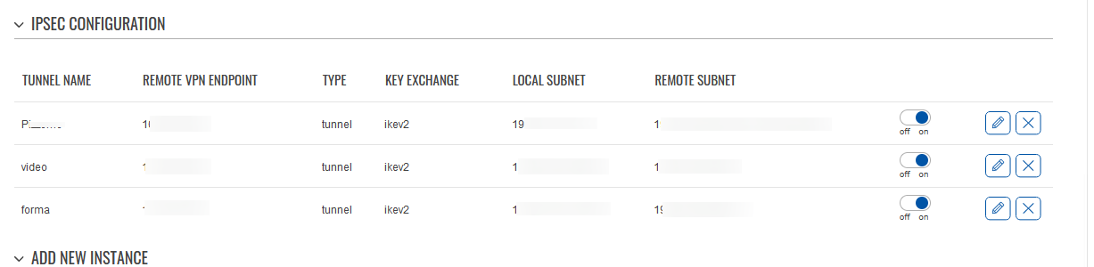

First, you mentioned that you route all traffic via VPN (default route). However, it seems that you have 3 IPSec instances. The first thing I would suggest is to disable other IPSec instances and leave only the one needed for SMTP for testing. Next, I would suggest checking the routing via CLI. CLI instructions are available here. Make sure you enter ‘root’ as the username for CLI/SSH. The following commands can be useful in your case:

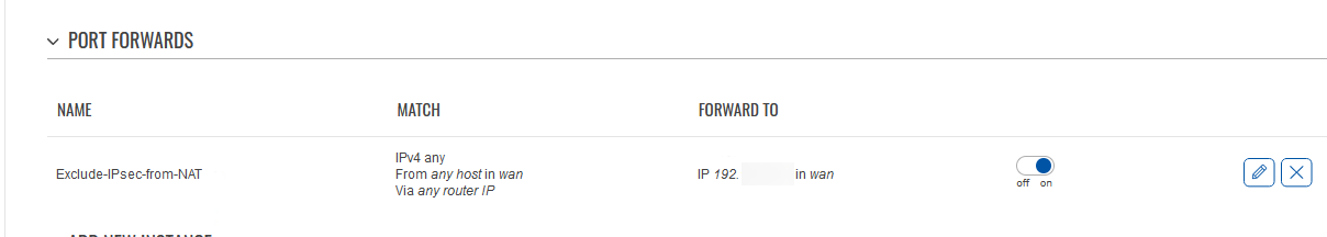

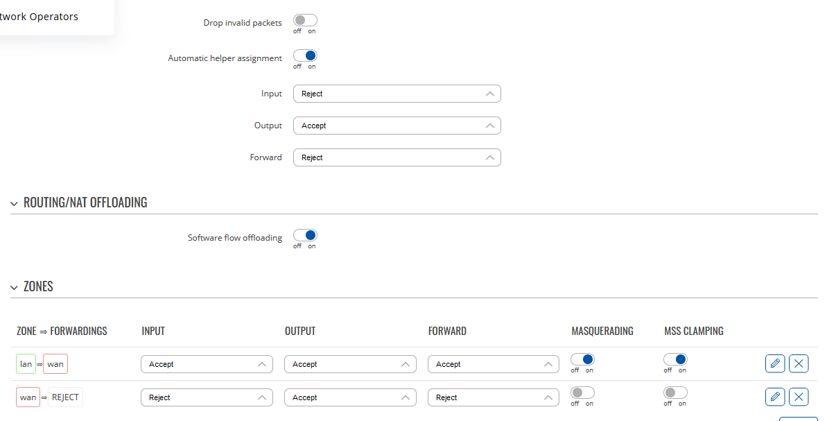

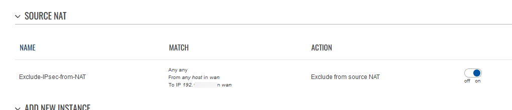

Also, the Firewall (zones/SNAT/DNAT) are all seems to be modified. There should be no need to modify NAT and Port forwards. You also have masquerading enabled on LAN, but not on WAN. Is starlink performing NAT in your case? Also, the NAT on LAN is usually enabled in specific cases. Maybe you could provide more information on why it is enabled in your case?
Since there is no way to share files privately, I have no information about all of your other settings. I would suggest restorting the device to factory defaults and configuring everything again without firewall changes (or minimal).

It seems that the tunnels are established and the routes are there.

If no packets are received on the other device, the issue may be related to firewall settings on RUTX11. As mentioned, there are quite a few firewall changes according to your screenshots. Hence, I would suggest restoring the device to factory defaults.
