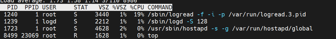

Worse yet, the router keeps indicating that it is updating the log database even after a factory reset. This doesn’t go away, and a process logread is very active, even after a factory reset.
