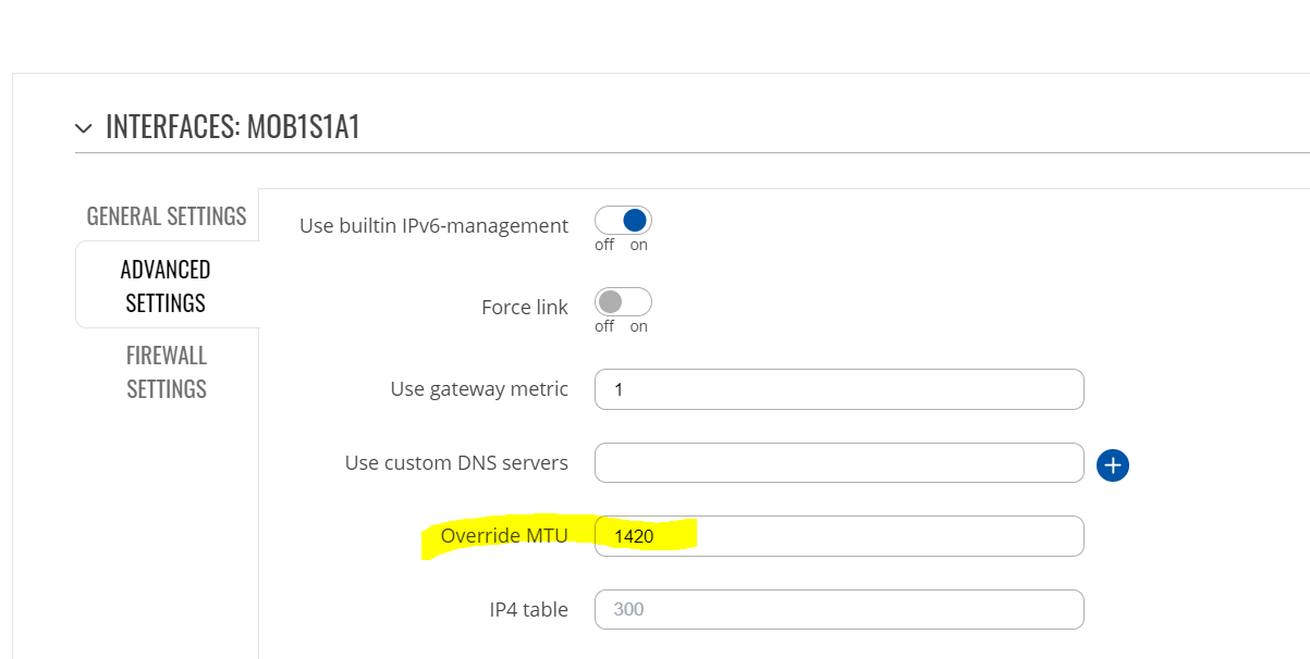

With a default MTU of 1500 bytes there is no need to override it.
Could you clear this field and retry ?
Thank you flebourse. I just deleted the MTU line in the GUI.

Around 48h ago I updated my RUTX11 to the latest (beta) firmware version RUTX_R_00.07.04.5 via file (manually downloaded from Teltonika Website) and I set the MTU overwrite option in the WebUI to 1280 and then reboot.
Since this everything is running without problems so far. Also my IoT devices are working fine again.
