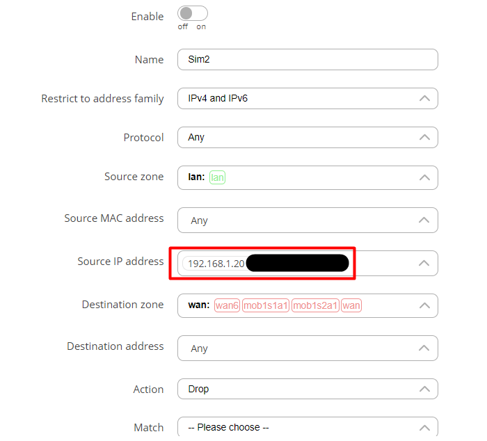

  1. I created a traffic rule that will block 192.168.1.20 to access the WAN interface:
  2. I enabled sim switch when there is no connection for sim 1, it will switch to sim2
  3. I had a custom script that will check the status of SIM2. If SIM2 is down, the traffic rule created previously is disabled. But if SIM2 is up, the traffic rule will be enabled.

The firewall number will vary on the configuration. To verify, once the firewall rule is created, run this command on CLI: uci show firewall
