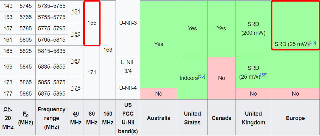

Indeed, the router has selected a DFS channel that has a limited output power in the EU:
Could you manually set the 5GHz WiFi channel to 36 and check if the issue is still present?

Well, if the issue ever reappears, try the suggestions, as the router might have switched to a different channel afterward and the issue disappeared.
Correct. DFS can be quite complicated, but it’s purpose is to scan for any radar presence, and if it’s present - switch channels. DFS spectrum is quite large, as different radar frequencies can be used in different countries/regions.
Of course! This is a public Wikipedia article:
Hope this helps!
