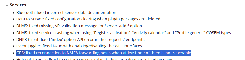

As per the changelogs found in the device firmware download page, since version 7.17, this has been the only GPS-related change:
Changelogs can be found here: RUTX11 Firmware Downloads - Teltonika Networks Wiki
No other announced GPS-related changes are known to us.
