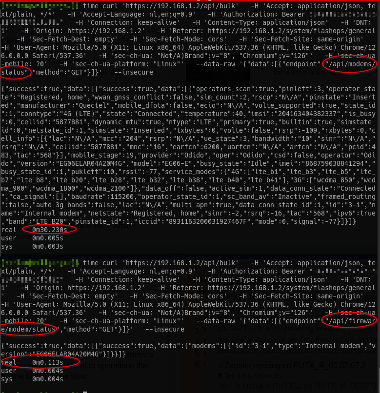

Since firmware RUTX_R_00.07.07.1, and not solved in RUTX_R_00.07.07.2 the web-interface is very slow when modem operations are involved. I have narrowed it down to operations that involve /api/modems/status. Here are two examples, one fast and one slow:
Because new users in this forum can only add two links in the text I have added a screenshot of it.
How to resolve this?

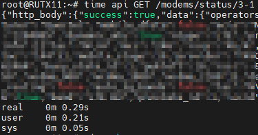

Also confirmed on CLI:
time api GET /modems/status/3-1
real	0m 30.29s
user	0m 0.20s
sys	0m 0.06s
Same directly on system:
