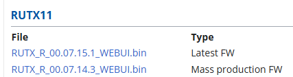

The way you want to do approach this, is you head to the Firmware Download page, found here: RUTX11 Firmware Downloads - Teltonika Networks Wiki
Either download the Latest FW or the Mass Production FW (choice is yours):

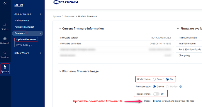

Then head to the WebUI of the device, under System → Firmware → Update firmware select Update from: File:
Make sure your selections are identical to the screenshot.

Note: Since you’re not keeping the settings, the password of the device will be reset to the default that is located on the back of the device.
