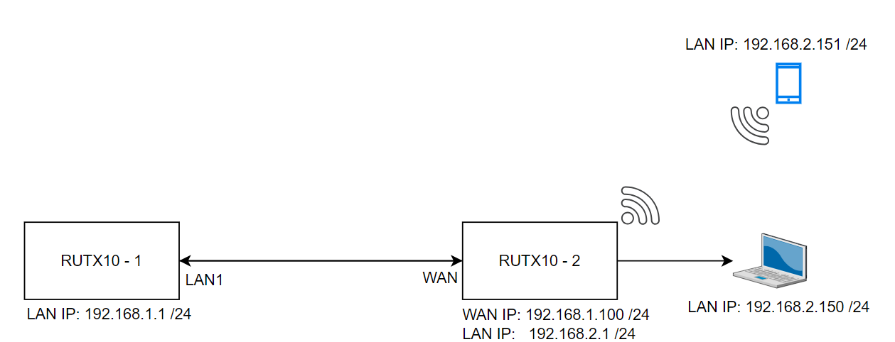

So in your topology, the first RUTX will provide internet connectivity for the second RUTX. Then, the second RUTX will be on a different subnet and will provide IP to devices connected via wired and wireless. Is it similar to your requirement?

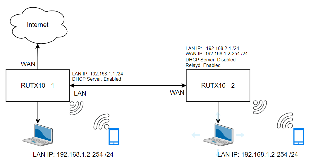

From my understanding, your topology will look something like this:
The first RUTX will be responsible to give internet and to provide IP to end devices. This means that all end devices are able to communicate with each other and will be on the same subnet.
Here is how you can configure it
First RUTX10
Nothing much to configure here. You just need to set the DHCP range and Wi-Fi settings.

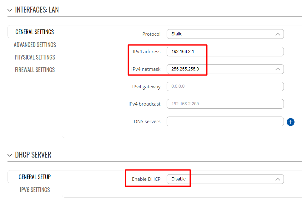

Go to Network → Interfaces → General → Click on the pencil icon and change the LAN IP to 192.168.2.1. Then, disable DHCP. Once you disable DHCP, you will lose access to the router. You need to put a static IP in 192.168.2.0 /24 network. Save and Apply

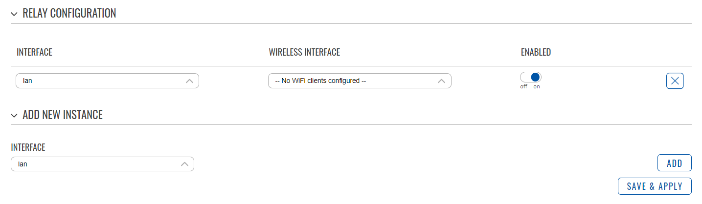

Then, go to Network → Interfaces → Relayd. If it is not there, you can go to Services → Package Manager → Install Relay Configuration. Add New Instance: LAN, then click save and apply

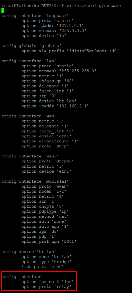

Then you have to access CLI to add one line. You can access it using WebUI or PUTTY. Once you logged in, enter this code
vi /etc/config/network
To edit press ‘I’. On the last line add option network ‘lan wan’. Then Press Esc, then ‘:x’. Then Enter.

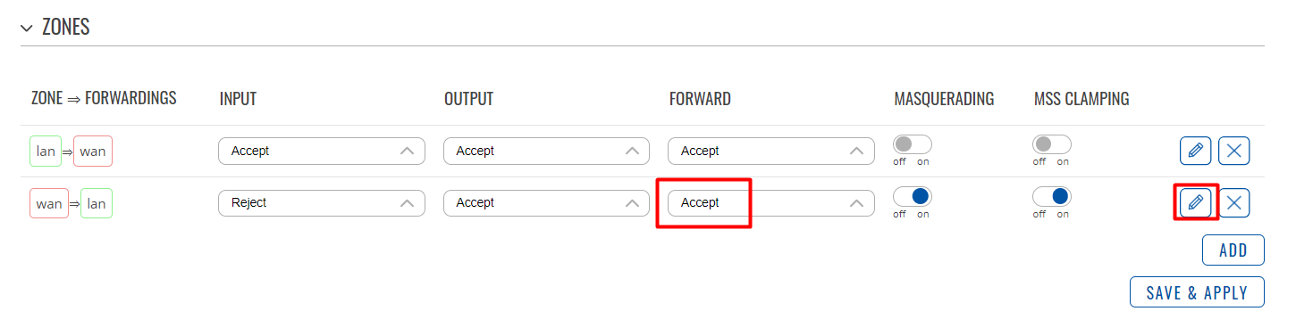

Lastly, for the devices to ping each other, go to Network → Firewall → General Settings
Then click on the pencil icon, add ‘lan’ on the destination zones.
After configuring, end devices connected from the first RUTX should be able to ping end devices from second RUTX.
