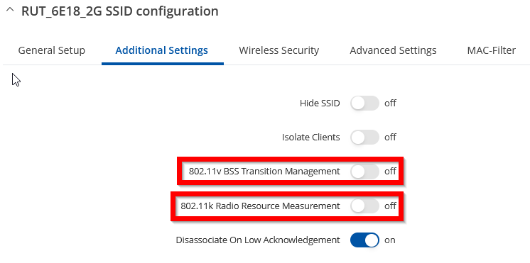

Improving your Wi-Fi connection might be challenging due to various factors like device compatibility, signal strength, network load, and QoS.
However, some settings could help. Firstly, try enabling the 802.11k and 802.11v options in your Wi-Fi settings. These settings may significantly improve reconnection times.
