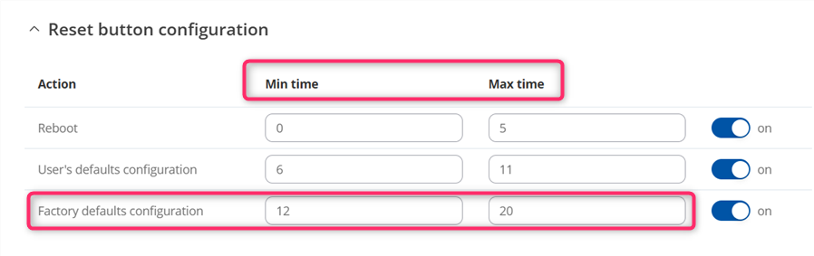

Hi, I’ve the same problem with the RUTX10, the hard reset button doesn’t work ! How to solve it ?
Hello @laurentw,
Have you tried accessing your device via the bootloader? Here is a wiki page with instructions for that and other device recovery options: RUTX10 Device Recovery Options.
