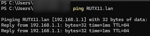

Is this similar to what you’re looking for?
This looks to be working with both the option 81 being in place and without it.
If you could clarify, it would be great,

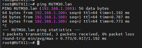

We’ve re-tested this by pinging from the RUTX11 LAN to the RUTM30 WAN:
Looks to be working as intended without any issues. Are you able to test this with your current configuration that you’ve mentioned?

Firmware versions were both the latest (at the time, I think they were 7.14.3); currently, the latest is 7.16.1
Hostname, as seen in the screenshot, is RUTM30.lan, which is the default - this can be edited under System → Administration → General, here’s a link: RUTX10 Administration - Teltonika Networks Wiki
The DNS server of our WAN infrastructure is the WAN gateway. Let’s say, for example your device has a LAN IP of 192.168.1.1 - once you connect it to a different router with the LAN IP 192.168.10.1 and you get the WAN IP of 192.168.10.55, then your DNS server would be the 192.168.10.1 device.
