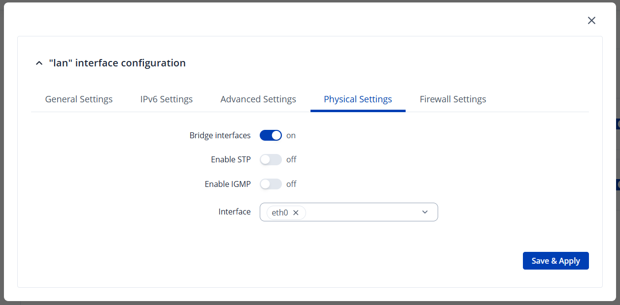

Within the RUTOS configuration, the “lan“ interface has bridge mode enabled, but STP disabled. Our DMZ interface does not have bridge mode enable, which therefore means STP is still disabled, but BPDUs are detected on boot. When the router is in normal operation, no BPDUs are sent from these interfaces.

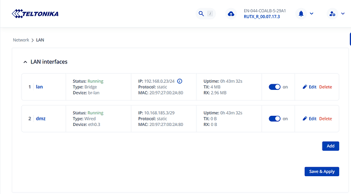

In the meantime, could you please confirm which interfaces are currently bridged with the LAN interface? I also assume the issue is noticeable when running the latest firmware version, 7.17.3, as well?
Additionally, would you be able to provide screenshots of the configuration sections where changes were made? Thank you.

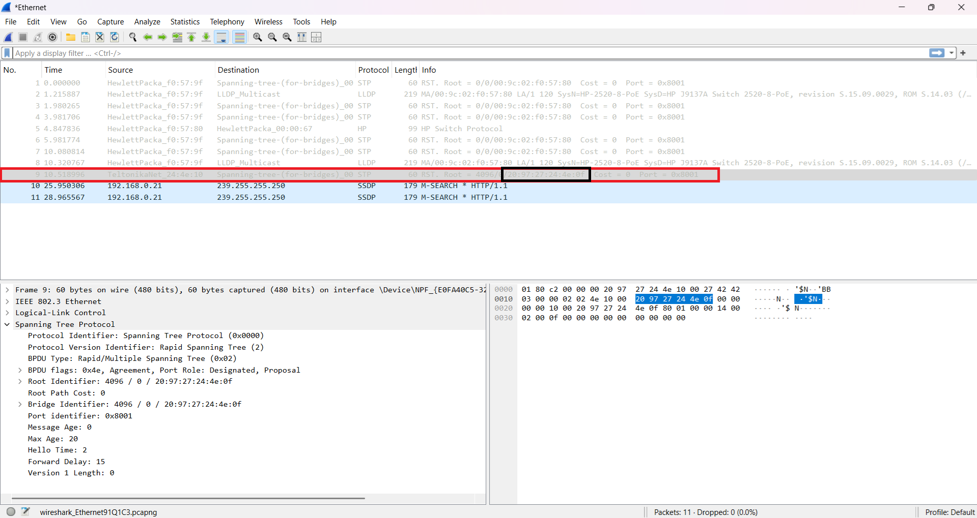

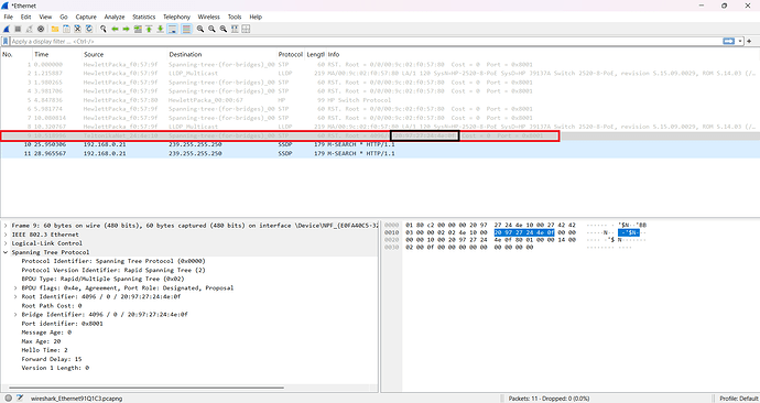

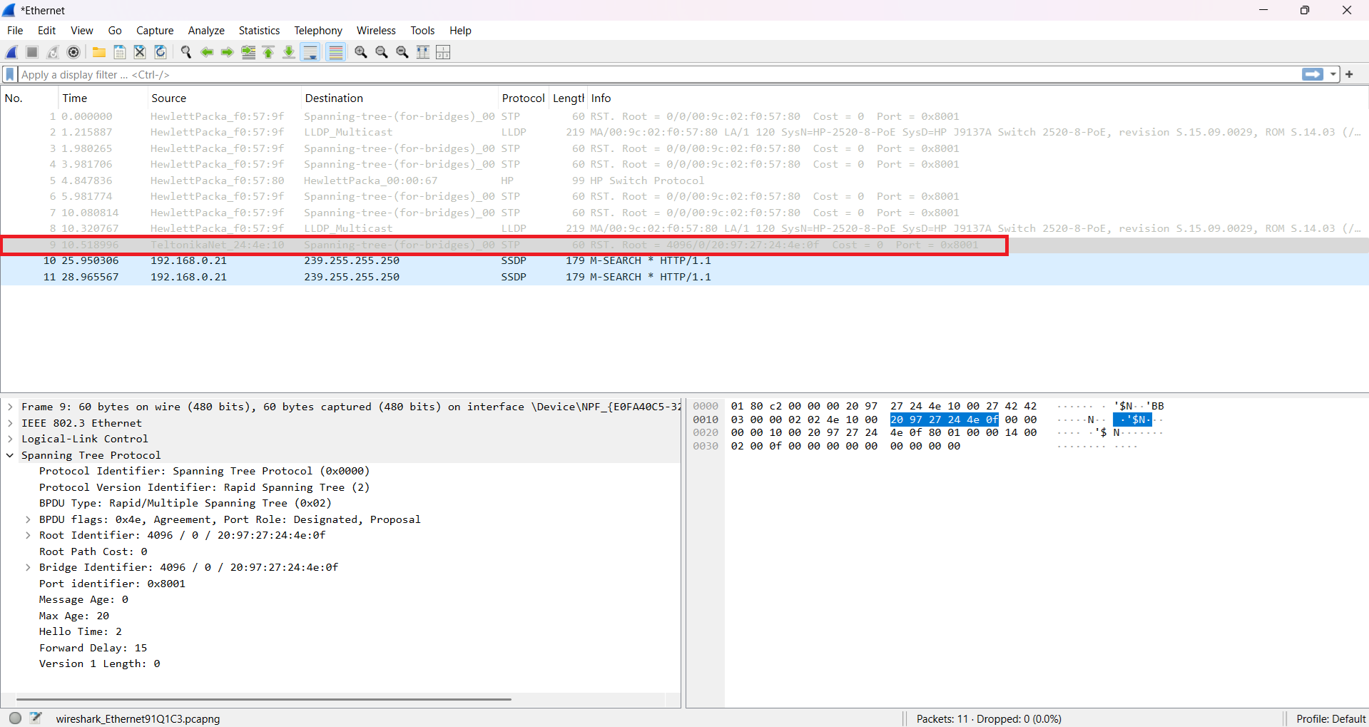

I have captured in a pcap the stp packet from the RUTX09.

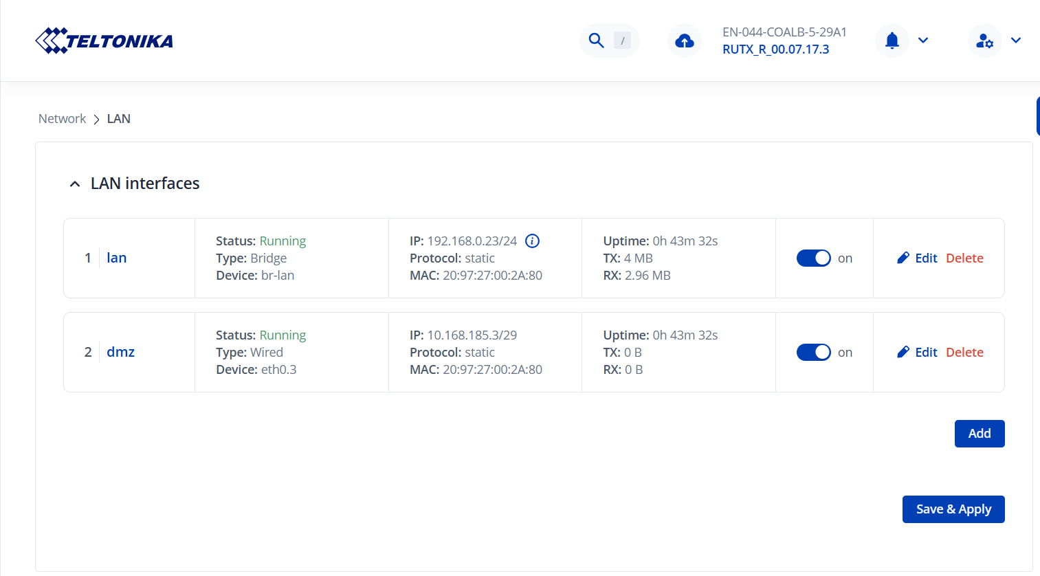

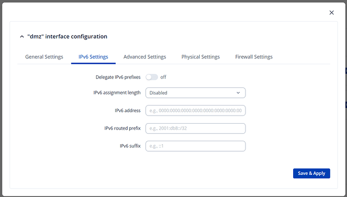

List of my LAN interfaces. I have also created my DMZ interface under the WAN section and the same issue has been seen.

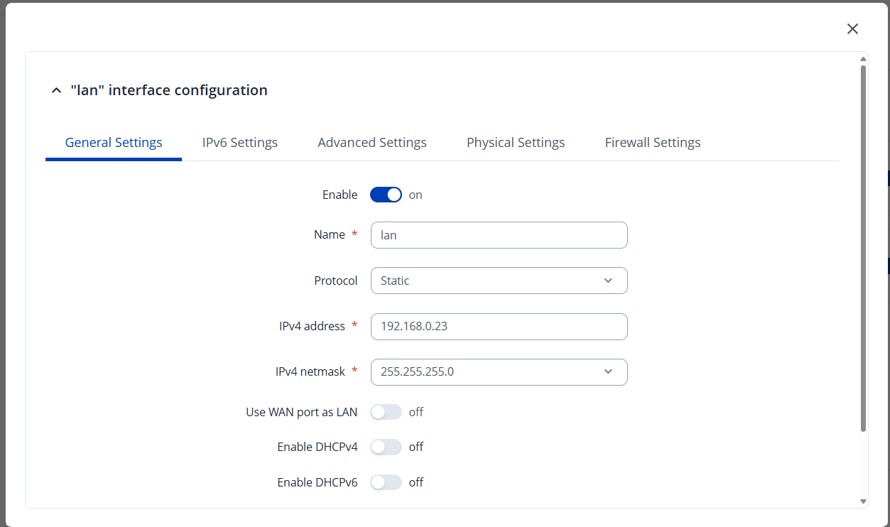

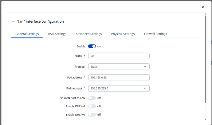

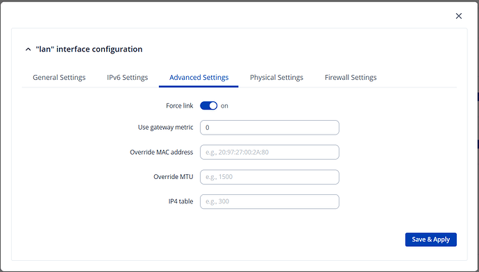

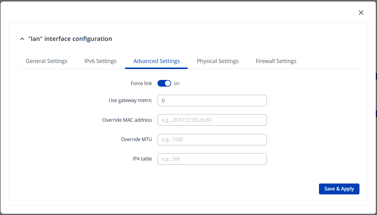

Configuration of the “LAN“ interface.

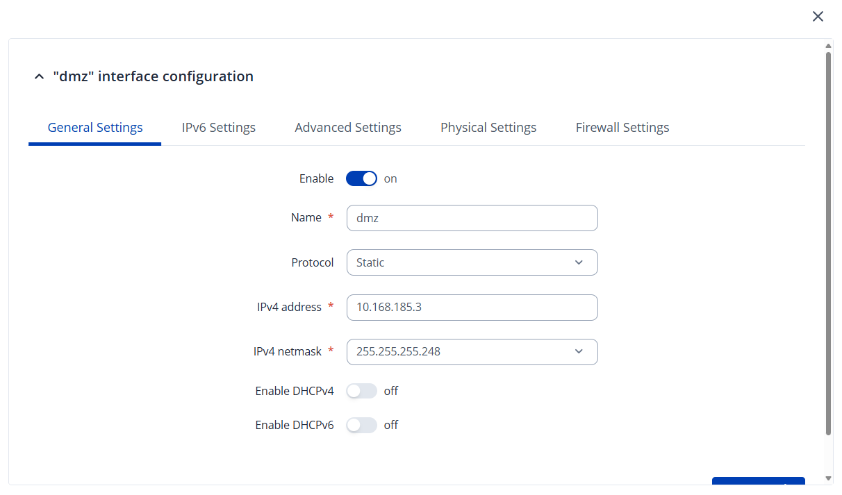

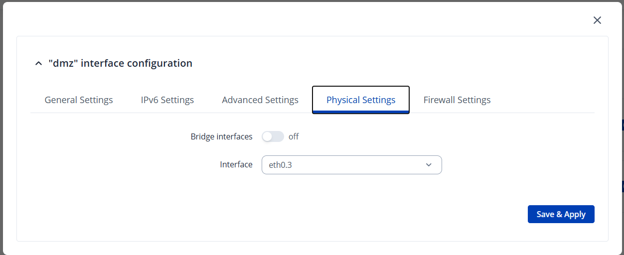

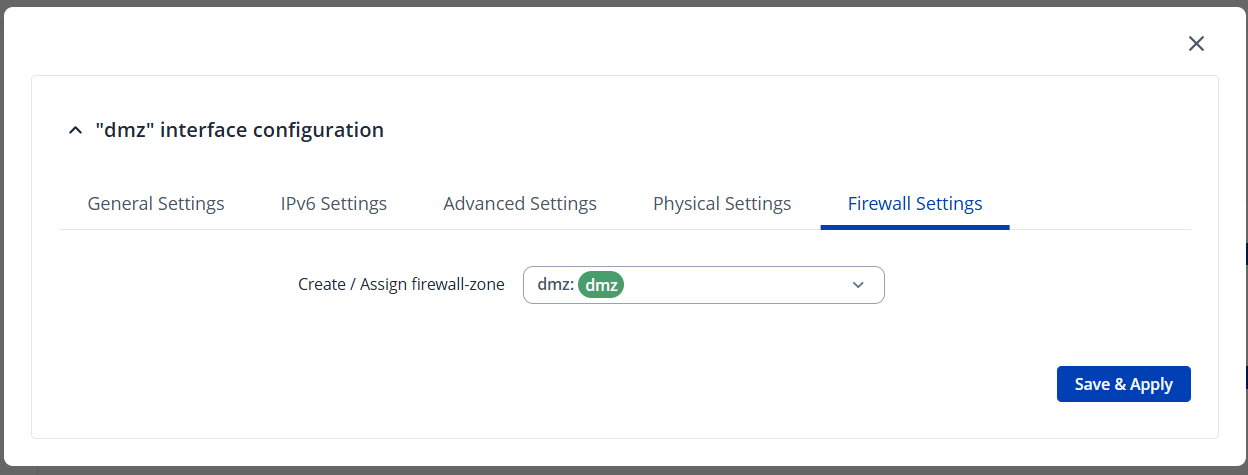

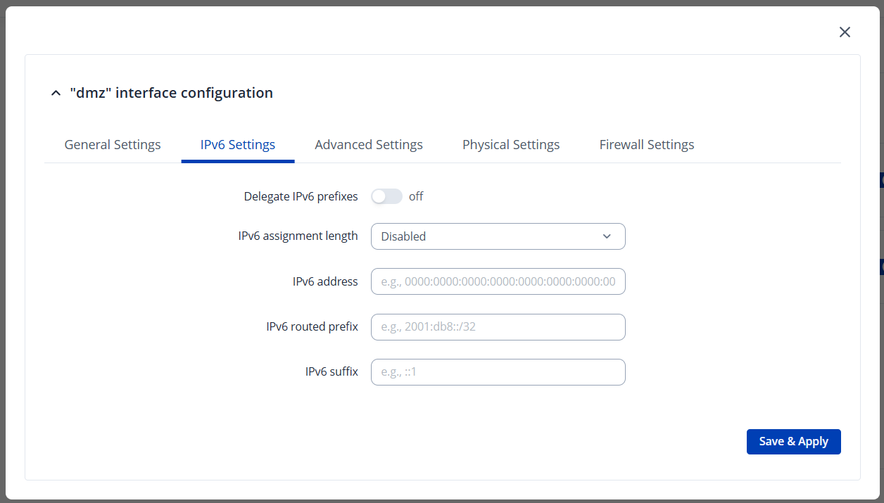

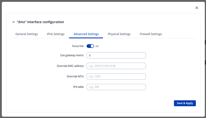

Configuration of the “DMZ“ interface.
I have tried to turn off bridge interfaces and force link on both lan and dmz interface and alternate the configuration to see how to prevent BPDUs. But the configuration above is used on RUTX09 routers running 07.07.3 and there are no BPDUs when the router initialises.

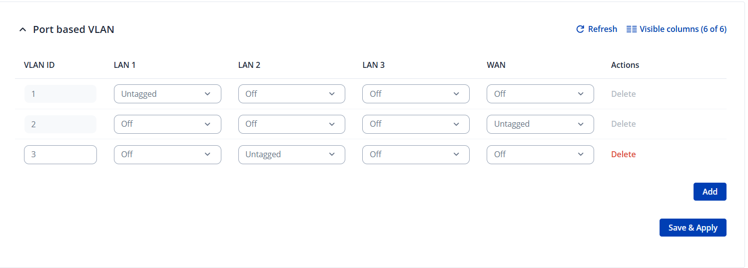

Here is the configuration of the port based vlan section.
I have also tested with routers that have a LAN MAC address beginning with 20:97:27 and 00:1E:42.
Hi Martynas,
I have just double checked the STP packet again in the Wireshark screenshot and the 20:97:27:24:4e:0f MAC address corresponds to my TSW212 switch connected to the LAN interface.
So, the issue looks like the BPDU is forwarded rather than generated by the router. Do you have any guidance on this?
