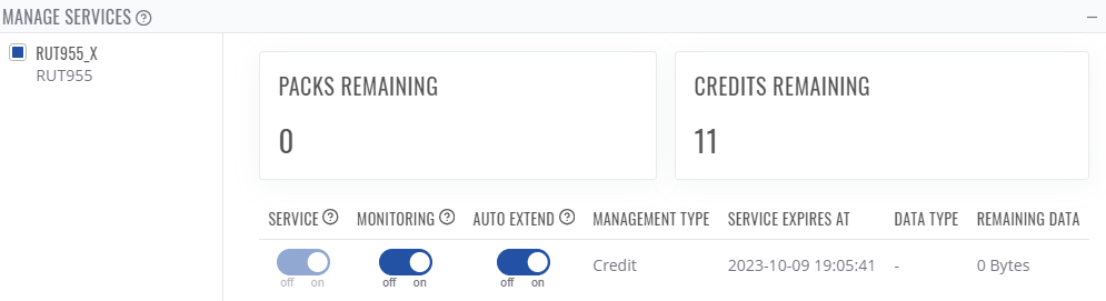

I assume the monitoring is enabled in RMS itself? Management → Devices → Your device → Device → Manage Services:
You could please try removing the device from RMS and adding it again?

RMS is enabled.
