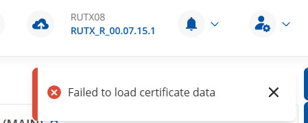

One issue I saw on 00.07.15.1 was a popup each time I reloaded or change page on the GUI stating “Failed to load certificate data”. I do not know if it is in anyway related to the WireGuard issue but anyway it shouldn’t be there.
