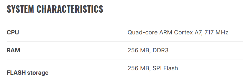

  • The RUTX08 has a four-core CPU as well
  • The RUTX08 web interface would show 100 % load only if all four cores were 100 % busy, giving that
  • the RUXT08 saying it is at 25 % busy actually means that one core is maxed out
  • because OpenVPN runs only single-threaded?

Correct, under the “Features” tab on our website, you can see that it has a quad-core CPU:
That would be correct.
