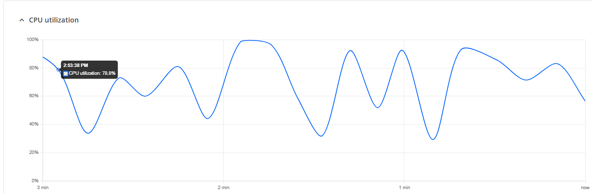

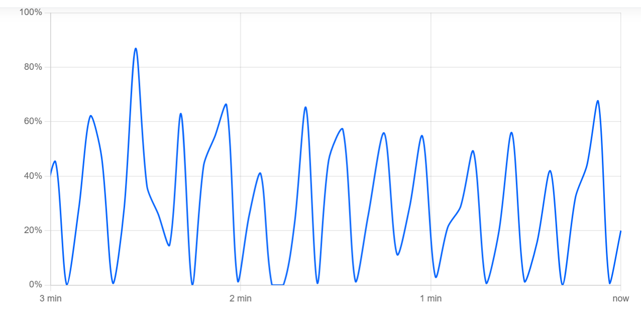

I am wondering if anyone who is one the 16.1 firmware, have noticed any CPE spikes since the firmware upgrade.
I am currently not pushing any traffic except wireguard and tailscale.
Hi There

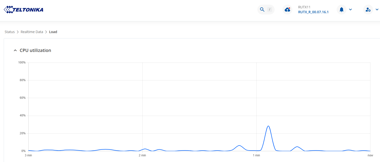

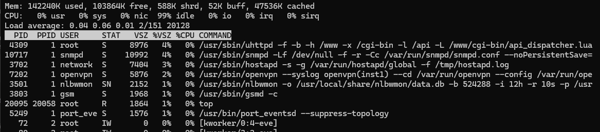

I currently have a few extra packages installed & an OpenVPN connection constantly running on the device with the latest 7.16.1 firmware. I am using a RUTX11 for these tests and don’t seem to have any issues with the CPU usage being as high as yours:

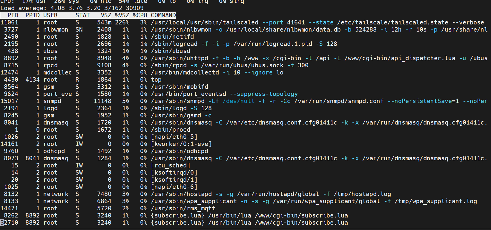

You can run the command top in the SSH window to monitor which services are taking up so much of your CPU usage:

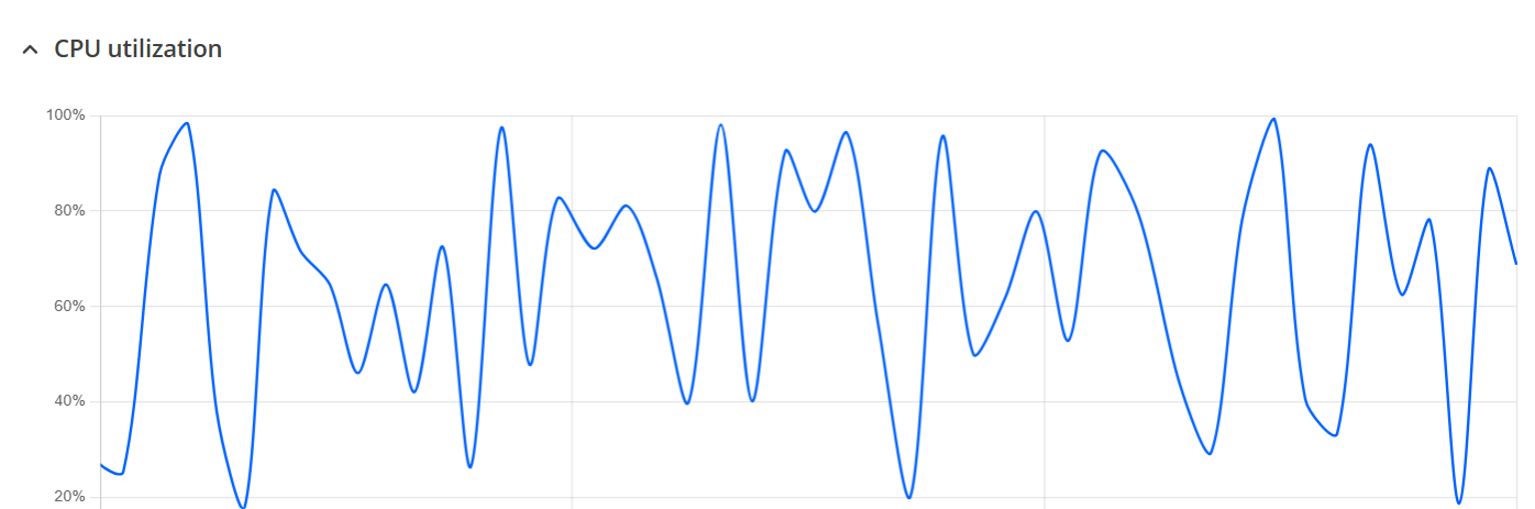

I just defaulted the device no lan traffic or VPN services but its still the same
something is wrong with this firmware.
