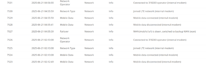

RUTX_R_00.07.15.1 bug? ... Failover; WAN (mob1s1a1) is down, switched to backup WAN (wan)
If this is not a bug, please help me understand what is going on and how to fix. This started happening just 2 days ago when I updated to FW RUTX_R_00.07.15.1
I keep getting these log messages but ‘mob1s1a1’ is the backup / failover connection and ‘wan’ is the main connection, which has not gone down at all.

In the provided troubleshoot file, there were no logs related to the failover. We previously requested another troubleshoot file captured when the issue is replicated, but we have not received it yet.
