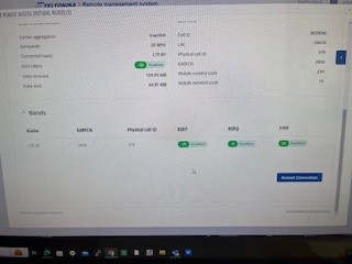

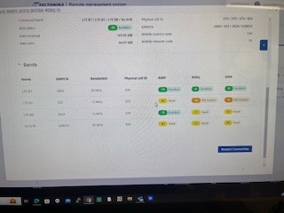

At initial start up all cells shown then these then disappear to only show the strongest. No connection to 5G NSA anymore. Previously this was consistent and all bands shown.
gsmctl -A ‘AT+QCAINFO’ shows LTE bands 7,1,8 and NR5G 78
this then changes after a period of time to just band 7
At start up or connection reset we see
root@RUTX50:~# gsmctl -A ‘AT+QCAINFO’
+QCAINFO: “PCC”,2850,100,“LTE BAND 7”,1,379,-78,-8,-50,30
+QCAINFO: “SCC”,323,75,“LTE BAND 1”,1,379,-86,-11,-66,21,0,-,-
+QCAINFO: “SCC”,3624,50,“LTE BAND 8”,1,379,-73,-11,-52,13,0,-,-
+QCAINFO: “SCC”,628032,7,“NR5G BAND 78”,859
After a short period of time we see just the one
+QCAINFO: “PCC”,2850,100,“LTE BAND 7”,1,379,-78,-7,-50,24
