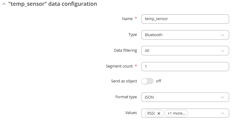

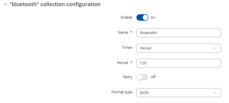

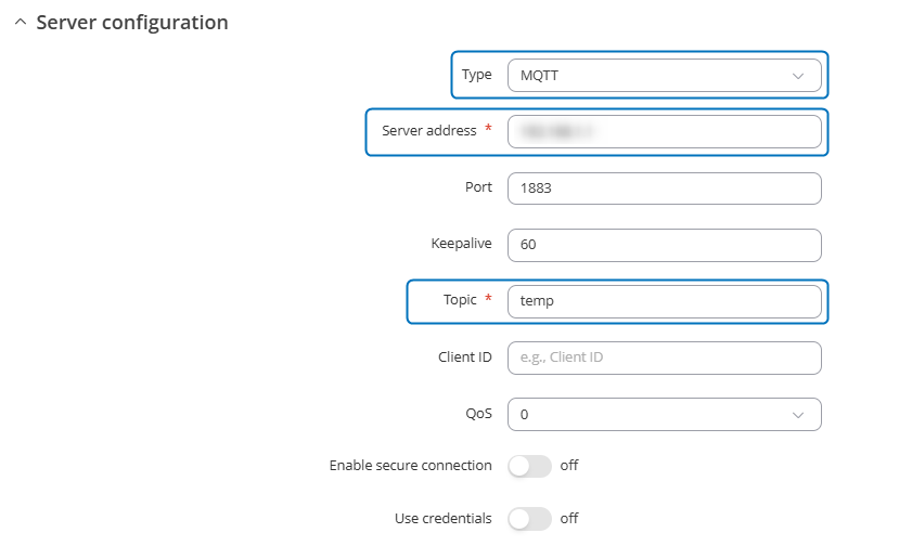

Regarding your scenario, forwarding Bluetooth sensor data to an MQTT broker and subscribing to it via Home Assistant, this is indeed possible to achieve on your RUTX11 router. You can use the Data to Server service to send Bluetooth data to your MQTT server or broker.
Detailed information and useful instructions for the Data to Server service are available here:
Bluetooth Data to Server config example for reference

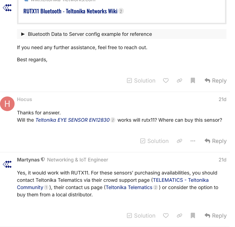

Thanks for answer.
Will the Teltonika EYE SENSOR EN12830 works will rutx11? Where can buy this sensor?
Yes, RUTX11 should support the EYE sensors mentioned here. For these sensors’ purchasing availabilities, you should contact Teltonika Telematics via their crowd support page (TELEMATICS - Teltonika Community), their contact us page (Teltonika Telematics) or consider the option to buy them from a local distributor.

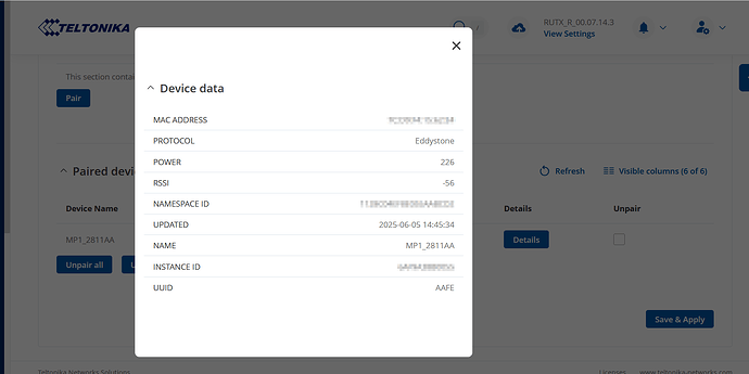

I bought a Teltonika EYE SENSOR EN12830 and I’m trying to pair it with RUTX11, but after PAIRing, there is no PIN code on RUTx11 and it doesn’t show temperature data. It only shows MAC and connection strength, but doesn’t decode temperature and other data? Where i should add sensor BLE PIN code?

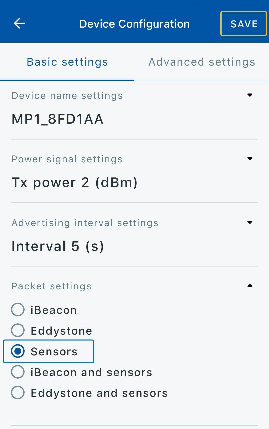

Our developer took a deeper look into this and managed to find a workaround for receiving data from the EN12830 EYE sensor. This method should potentially work on your side as well:
  1. In the EYE app, go to Device ConfigurationBasic settings.
  2. Under the Packet Settings section, select Sensors and click Save:

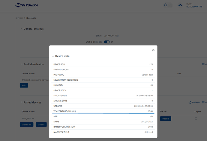

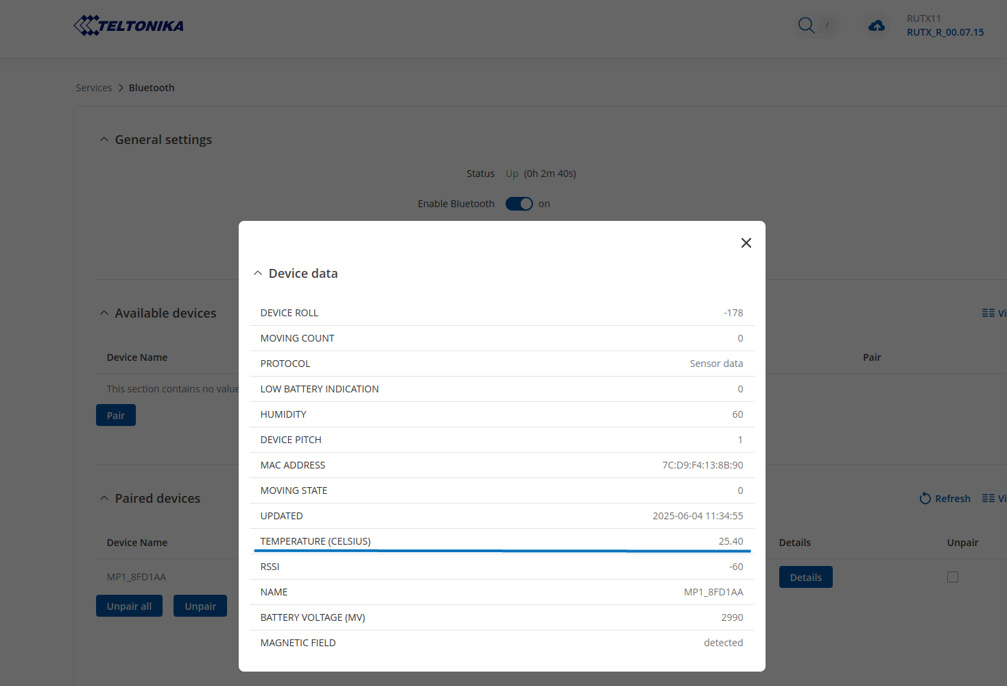

  3. After this, the temperature data should start appearing in the Device Data page on your RUTX11 (you might also need to unpair and re-pair the sensor for the change to take effect).
I hope this helps resolve the issue — and once again, sincere apologies for the inconvenience, and thank you for your patience and understanding.
