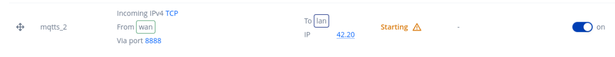

Using the webUI to add a firewall forwarding rule to DNAT inbound traffic from wan to iot zone results in addition of a rule that appears to map traffic into the lan zone, when it should be mapping the traffic to iot zone.Attempting to enable the rule via the webUI results in the rule getting stuck at “starting” status.
More broadly adding a forwarding rule with a destination in any zone adds the rule with lan as destination zone

Warning: Section '45' refers to not existing zone 'lan'

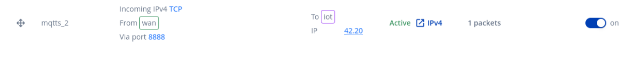

Correcting the config
uci set firewall.45.dest='iot'
firewall.45.enabled='1'
uci commit
back on the webUI, the config looks correct (the right zone is associated with the rule) and can be enabled and disabled successfully via the webUI.
