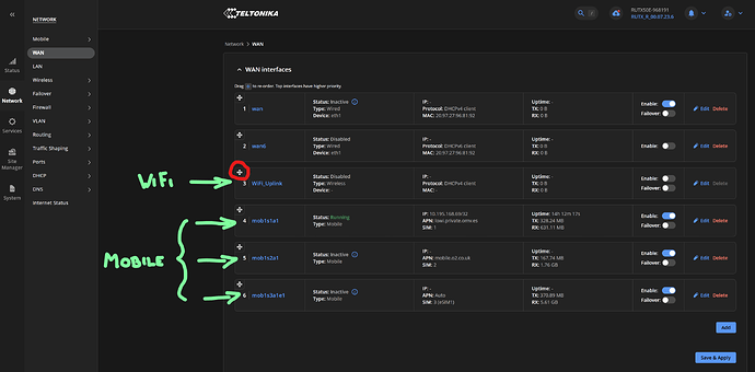

In your WAN Interfaces, is your wifi uplink prioritized over and above all your mobile connections?
If not, change it by grabbing the handle (circled in red) and dragging the interface to the correct position.
Your WiFi as WAN interface may be named as the default ‘wifi1’ - I changed the name in my setup to ‘WiFi_Uplink’ to be more representative of its function.
